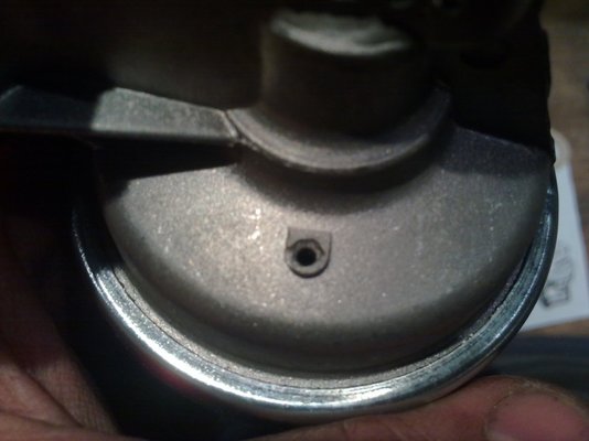

Last autumn i have bought new sofabex 8005 fuel pump(sealed tip) for my R4GTL 1128 - 1,1 688712 engine
Last weekend wanted to change my old sofabex fuel pump with new one.

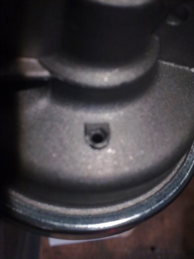

But when i looked little bit closer i have found small hole on bottom of the pump.
To be more confused that edge of that hole seem to be rough. Like something have broken from there.
Is that hole normal or pump is broken?
Thank you for reading!

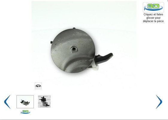

Think i have found answer!
On oscaro.com found VALEO pump for same car that looks just the same as sofabex and have same hole on pump.

If someone know why is this hole there please explain!
I believe that hole is there to allow air inside chamber to go in and out when pump sucks fuel in and sending fuel to carburetor

I think you got it right, petal - probably an air intake/exhaust for the pumping action.
I missed my question mark earlier, it's probably as you suggest a breather to allow the pump to work correctly.
