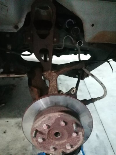

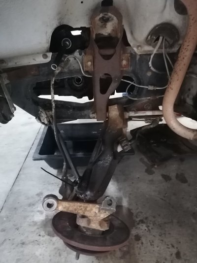

Hi everyone, today probably I made a big mistake.. I didn't put a support to compensate the torsion bar.. And now I have everything on the ground making too much strength.. Any tip for this?
First the GOOD news: had any part of your body been in the way, you could have been seriously hurt-and you're not! Do you have a scissor jack? Maybe use it to s-l-o-w-l-y raise the hub up to the point where you could bolt it in place?
Just a thought.....!

It's a little tricky but if you can get a jack in safely you can jack the lower arm up enough to connect the damper and upper arm balljoint.

some centimeters beside probably my feets got be hurted.. I have one scissor jack and a hydraulic jack for lift cars. What is the best recommend spot to make strength?
Tomorrow I will try something.. Not Wil be easy. I forgot totally to put an support, and now I have more work..
