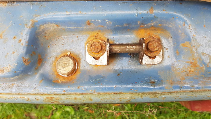

I know this is a common problem (I've had more than my fair share over the past 40 years!).
The tailgate on my GTL had been squeaking really badly for ages, so I removed the latch from the boot floor and used a Dremel to elongate the screw holes so the latch could be pulled outwards. The tailgate's now completely squeak free!
Worth a try if you have the same problem.

Great fix Andy, adding a few turns of electrical insulation tape on the central shaft can also help to eliminate the metal to metal contact and take up some of the 40+ years of wear within the lock. This also works for the bonnet lock!
Funnily enough, I cut off the electrical tape I'd had on the central shaft before I changed the position of the latch! The tape worked fairly well for a while, but I'm hoping that moving the latch will keep the tailgate quiet(er) for longer.
All of the TLs and GTLs I've had have had squeaky tailgates - thankfully intermittently!
I moved the catch inwards, so tightening the closure. As the rubber compresses, the closure become slacker and there is wobble room. So I did the exact opposite. The way to close the hatch now is to drop it from wide open, and hey it catches.
