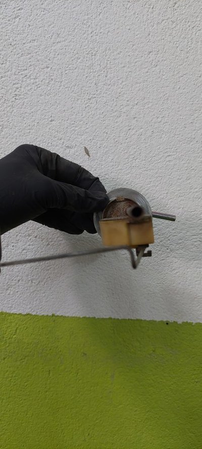

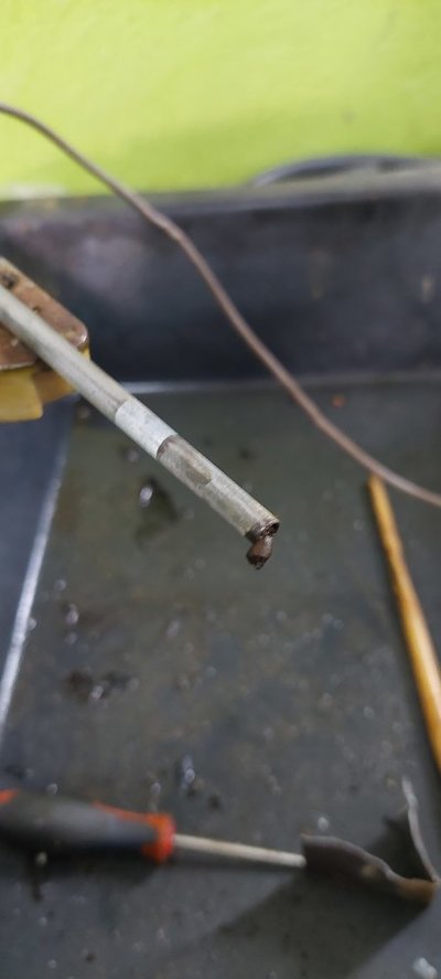

The stale (old) petrol may be blocking the petrol pipe from the tank to the pump. I think you might have to remove the tank and drain it and blow compressed air through the pipe to clear it out.
Now that you have the engine running you know the problem is the old petrol and a possible blockage in the pipes.
Bypass to fuel line From the tank to the pump.. the pump is ok..it push petrol to the filter
Air on the fuel line from the tank, and everything ok.. so let's check the tank.

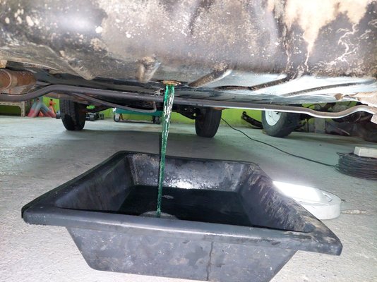

One time I have the tank out, I will/try clean the inside.
After 14years..
A little cleaning

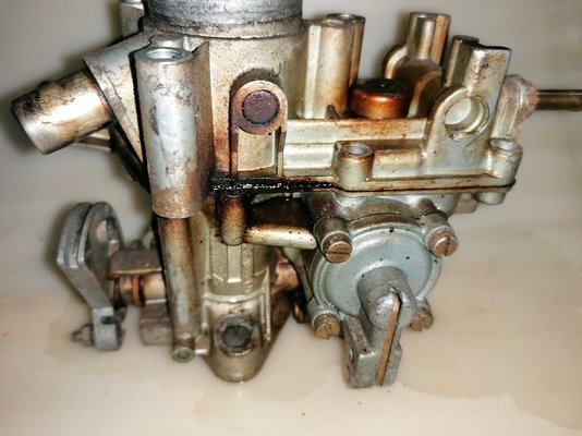

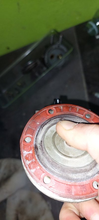

So I will start on the carb. It is an 28if v05084 with acceleration pump (i think)

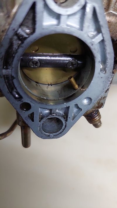

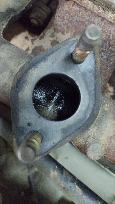

First impressions petrol on admission after more 24h without try start the engine
The needle valve have write M.9 instead 1.25
Anyone knows what is this small holes??
You've managed to have it running, which is progress! Once it's running properly you can address other problems. Remember the gaskets will have dried out, so may need replacing or might absorb some fuel, which will affect consumption. You may still have dirt in the pipes or carburettor that might need clearing again soon!
