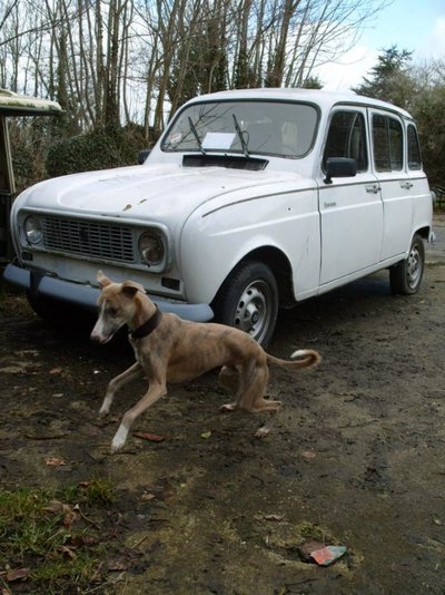

Happy New Year everyone,
I'm having some problems with my starter motor.
I have returned home and have managed to get the R4 going again
I left it to idle and the engine cut out after 5 minutes or so. When I went to restart it the starter made a "wurring" noise. It wouldn't stop even with the key removed!
I had to disconnect the battery to make it stop. If I reconnect the thick black cable from the starter to the +ve terminal the starter buzzes (engine doesn't turn).
I asked Weasel (pictured) and he reckoned the insulation on a wire has melted through causing a short. I thought I'd ask a more reliable source before taking things apart.
The solenoid clicks ok when you turn the key without the thick black cable connected to the starter.
Any ideas greatly appreciated

. I drove it up the drive and it promptly ran out of petrol!
