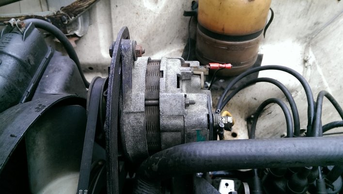

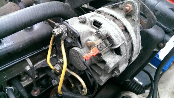

I guess that the regulator doesnt run prpoerly,the battery gets no load.so I hat to load it externelly.we) ll see whats happens,best regards jens

We found out the regulator is ok but the Generator is broken.
I guess it's the diodes.
now we need an Ac_ Generator ,ducellier

we will get a hire car later and hope to fetch a generator from anywhere in the vicinity of 100miles. Suggestions welcome. Let us know!
You might be able to find a new alternator in stock at a Motor Factor (car spares supplier). There are Motor Factors in Perth (nice town worth a visit) or Kirkcaldy or Glenrothes (not so nice towns to visit). You can find their numbers from http://www.yell.com and give them a call to see if they have one. Ask for an alternator not a generator.

the regulator still doesn t work properly,but with the secons battery we ll make it back to Germany.
