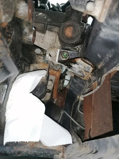

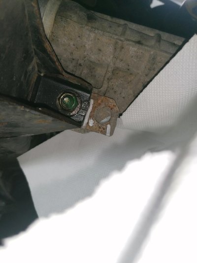

Hello everyone.. I'm trying to disconnect the steering arm of the bar, but is not easy..so I stop doing more strength..
It is true it have a frein lock the arm?

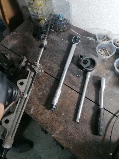

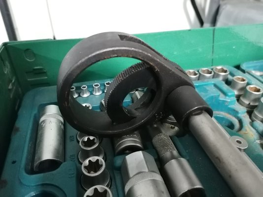

I'm using this tool:

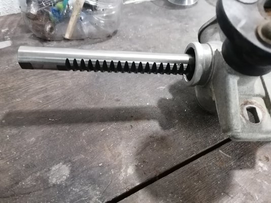

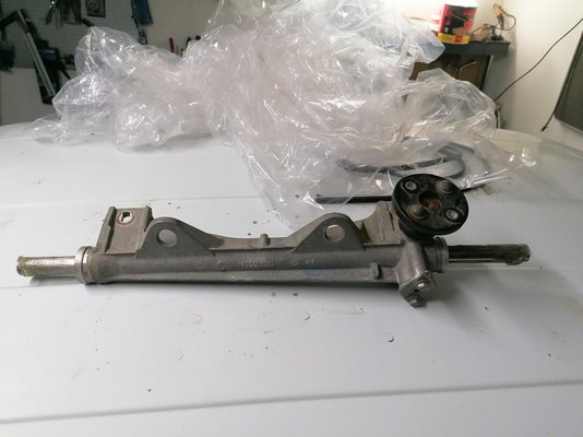

Bend the arrowed tab straight and it should be a little easier to loosen. It will need considerable force. To avoid damage to the steering rack remove it from the vehicle and clamp it firmly in a vice fitted with soft jaws, at the toothed part of the rack.
I think I will do that.. Remove the steering rack from the car.. It's necessary to mark this measure right?

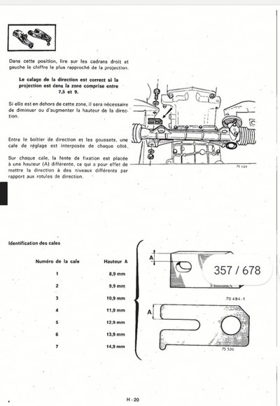

I have file in French l, but I don't understand everything..
