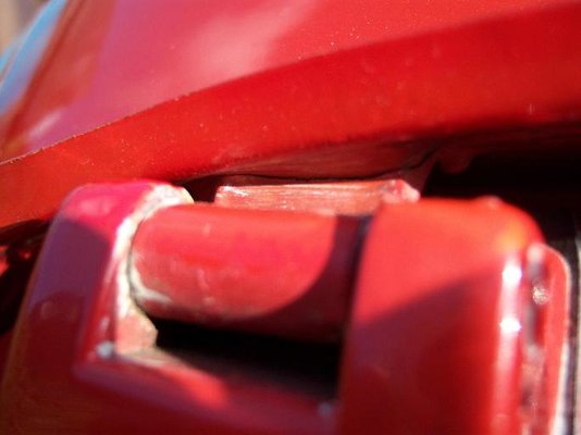

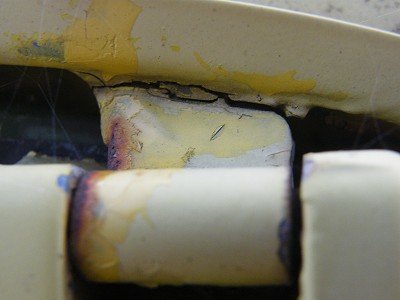

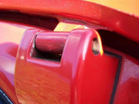

It might just be a crack in the sealant. The first photo has a hinge that looks bad, but I believe it's just the sealant that has cracked. It'll be letting water into the joint which will make the hinge mounting crack, so to repair the sealant and rust would be scraped away with a screwdriver, a good primer then polyurethane sealant, then body colour would make it better.

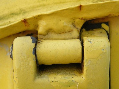

When rust finds it's way in the hinge can crack. This one has been welded to the edge of the roof which works OK.
If it is just a sealant crack then after resealing you might reduce the stress on the hinges by spraying lubricant at the pivot - in the centre section of the hinge.

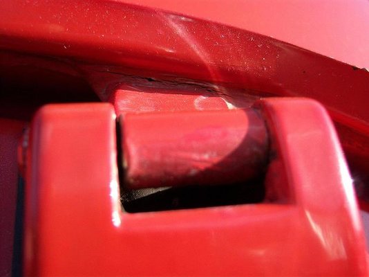

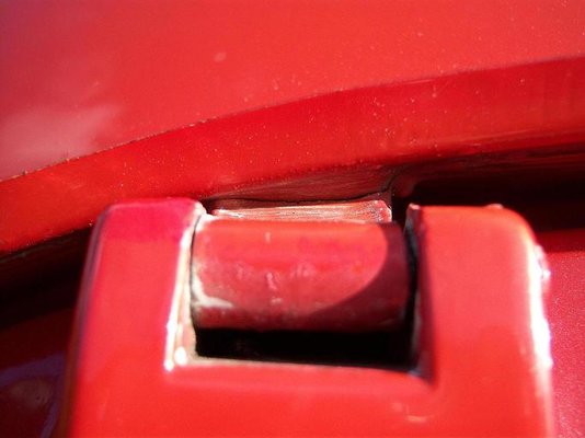

Here's the pictures of my cracked hinges, what do you think. don't repair what isn't broken or weld now for prevention?

Looks like it's just the sealant that's dried and cracked. Ideally it would be sensible to dig it out a little, clean up the rust behind and put new sealant on. Or just a bit of sealant to keep the water out of the crack.
