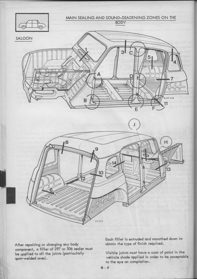

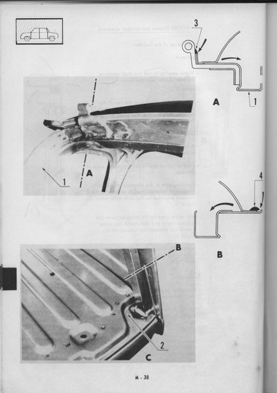

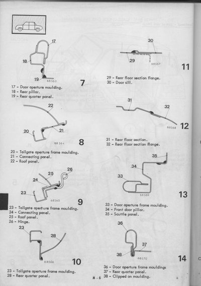

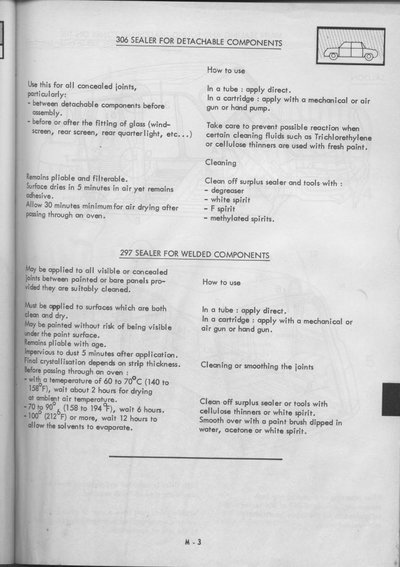

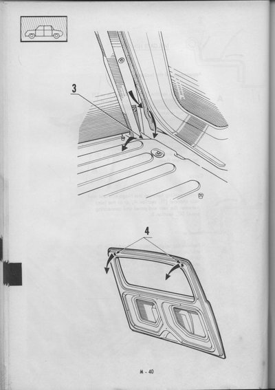

MR176, Chapter M should point you in the right direction. I've selected relevant pages.
