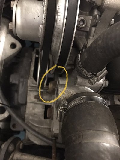

S sdvcatfish Enthusiast Messages 96 May 28, 2024 #1 Hi Experts. I have a Water Temperature Switch fitted on the Water Pump Housing on my 1108 4F4 1987 Fourgonette. There is no wire on it and no sign of any available connection. Can anyone show me how to hook up this switch please. Kind Regards Ian.
Sage103 Gordon Messages 171 Location Torphichen, Scotland May 28, 2024 #2 The visible threaded core is the positive feed to a temperature gauge so you just need to connect a wire to it using a nut and an o-shaped connector.
S sdvcatfish Enthusiast Messages 96 May 28, 2024 #3 That’s brilliant Thanks. Will get a Temperature Gauge Fitted. Kind Regards Ian.
