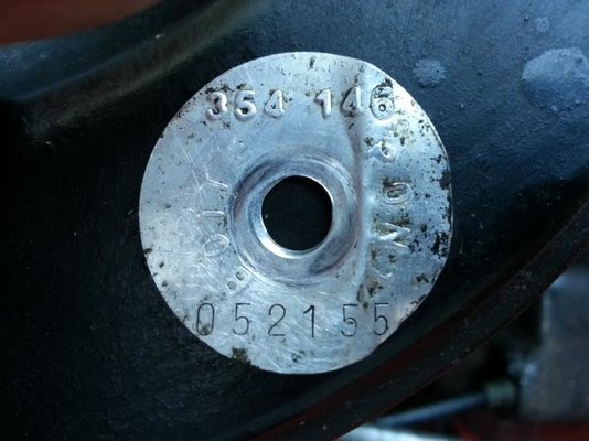

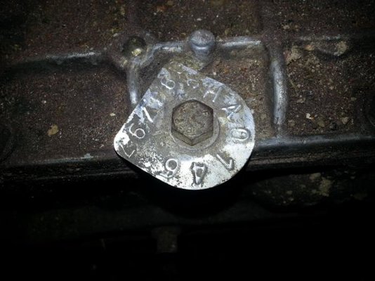

OK ... here are the tags of the two gear boxes involved. The one that's still on the gearbox is from the red car the bodyshell (and speedo) came from.
I've removed the tag from the other gearbox that came from my original blue car.
Both are 354/HA0 146.
As I have never driven the red car in a working state, I must presume that the speedo was fast all along, and that the old style speedo is more accurate.
BTW the car is on size 135 tyres at the moment.

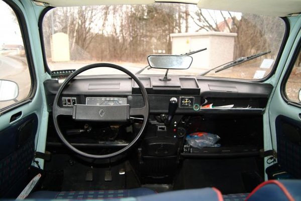

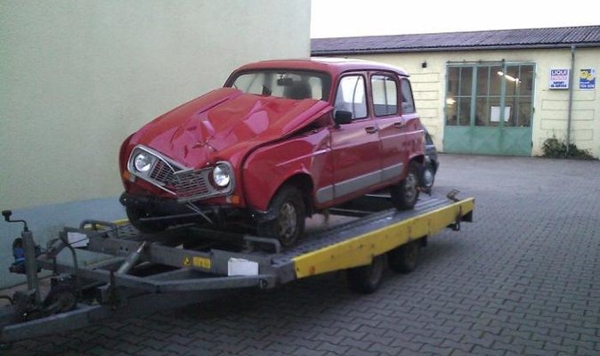

An elderly lady decided on an icy day that the ditch was a much more desirable location than the road :(
I haven't checked the chassis, but the shell was OK apart from the bonnet and the left front wing.
