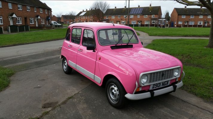

I have just started the R4 after a month of sitting and the Throttle or Choke seems to be sticking open. The cable movement of both seems OK so I guess it is something in the carb? Any ideas where to start looking?

The throttle cable had slipped off the bottom of the butterfly spindle and was holding the throttle slightly open. All fixed and ready for the road.
