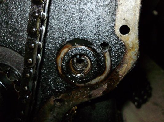

R1126 means 782 cc, all of these had hydraulic tensioners...better send us a photo of the tensoner itself and also the engine number.
seem to remember about 1975/6 renault used clockwork spring type for a short period on several types of renault they all went wrong so had to be changed back to hydraulic 2 bolt type
there was a technical supplement issued which was supposed to be added to the back page of dealers workshop manual detailing list of modded parts
think there is an oil feed blocked off which is needed for oil supply on tensioner and a dferent back plate
maybe some one has dead 845 engine to rob bits from ??
