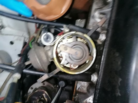

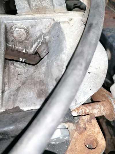

How is the position here?
After found this position, i will find that 1st cylinder on top, right? I don't know the term in English

The timing scale is the set of lines visible under the bolt head on your photo, not the three dots at the front of the aperture.
There is a notch on the flywheel, when it's opposite the far left line (as viewed on your photo), engine is at top dead centre. The rightmost line corresponds to 6deg BTDC, this is the correct ignition timing at idle with vacuum unit disconnected.

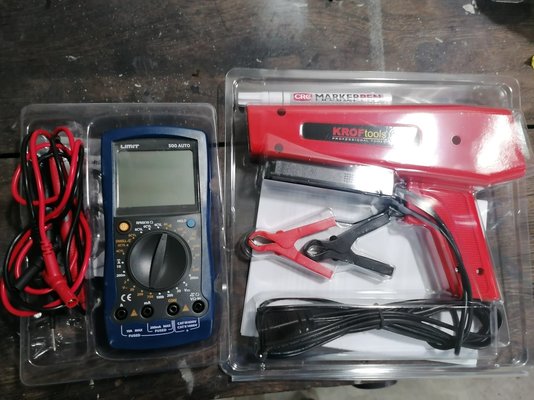

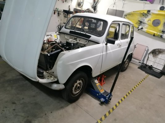

Today I prepare everything to do mesurmers..

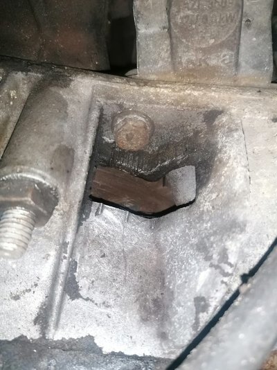

Wheel in the air.. To move the flywheel
6º marked
"Rotor" in direction to the spark cable of 1st cylinder.. The motor seems to be on good advance value.

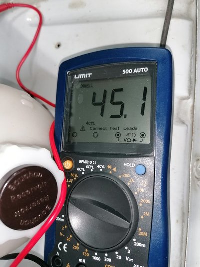

Dwell test..more Than one.. Different values, or I don't know do the test, bad multimeter measure or any problem, let's check..

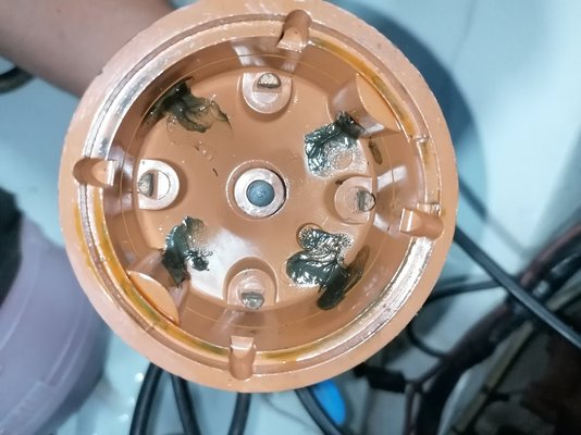

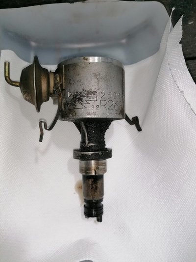

I don't know name of this in English... It's broken, probably original

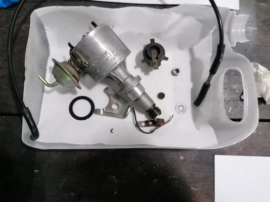

And let's take some cleanings..

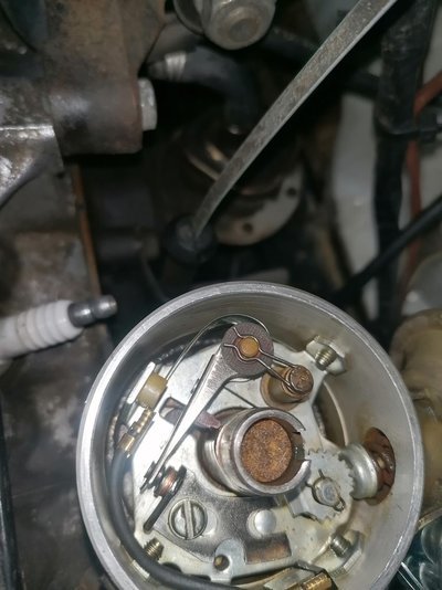

Today I had a little time to start install the new parts..
Timming setting, on the 2nd mark, gap of the platinum on 0.40mm, new paper junction.

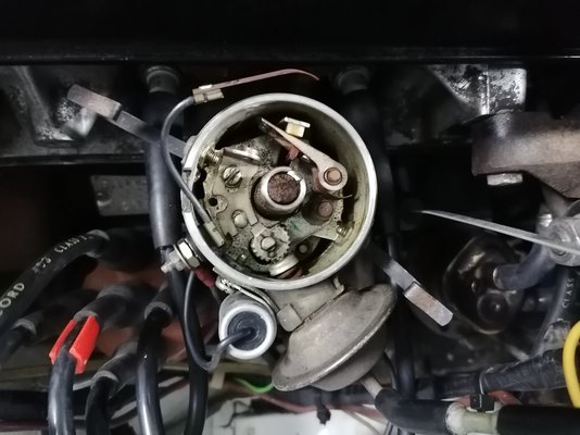

Are this the right position to set the dwell? This is the position on the ignition set mark on the clutch l.
When the engine is running and warmed up, what reading do you have for the dwell angle? I should be between 54 and 61 degrees, so 57 would be perfect. You need to ensure this is set correctly first.

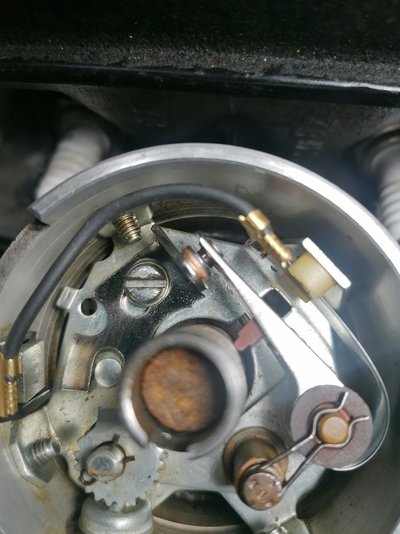

The value is 37 degrees, before had 27degress, when I have the enormous misfires. But I'm setting (0.40mm)before the lobe of the distributor, with the engine setting to the middle mark on the clutch. Is this correct? Or the right is do the setting in top of the lobe with the gap totally open?
Your dwell angle of 37 degrees is lower than the 57 degrees it should be, so you need to lower the points gap a fraction more. Remember, to increase the dwell angle you need to decrease the points gap, but only a very small amount. You need to measure the gap with the points at their most open, which is when the lobe is at its highest point. Looking at the picture above I don't think your points are quite fully open yet. Don't worry yourself with the markings on the clutch at the moment-let's get the points gap set accurately first!
So is that my mistake, I am setting before the highest point of the lobe. I will setting again. Thanks a lot!! I will share the results
Dwell set at 56degress..but I loss the smooth drive and some exitacion at low rpm.. And the exhaust noise is very powerful..
