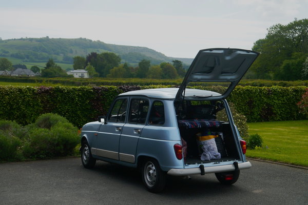

Our GTL had started to judder occasionally, which got worse and worse, especially up hills. It would idle fine. The points gap (on new points) was OK, the vacuum advance mechanism was working (checked by sucking on the tube), fuel filter was clean, coil resistance was OK, HT leads (fairly new) were all OK. There didn't appear to be a leak on the inlet manifold or base of carb (tested with WD40 when engine was running).
Had the carb cleaned by local garage, but was still running badly. Finally they replaced the condenser (and put in new points) and now he's running perfectly again. I only fitted the condenser less than 2 years ago.
