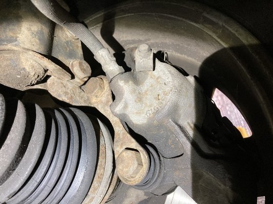

1. My friendly mechanic has advised that new front brake caliper sliders would be a good idea. Given the rarity of the Twingo in the UK the deal with the mechanic is that I find the parts and he fits them. Am I right in thinking that the brakes are Bendix (the caliper is stamped 350519 - see photo) and so I need something like https://www.ebay.co.uk/itm/284154715695
