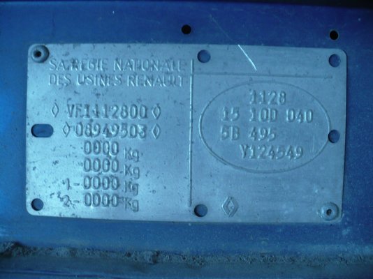

Here are mine plates
"oval plate" witch actually is not oval
On the left you can see vin number in two rows.
On the right (in oval) first number is model number 1128
495 is color code for my car
and last number Y124549 is production number of the car
Others numbers are some kind of equipment codes. I presume they are telling witch part of europe (or world) car is made for, what kind of upholstery car have, lower or higher interior equipment. But not sure. Just my thinking

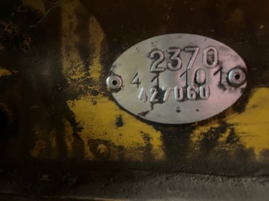

Engine plate from my car
first number is engine code
second number is production number

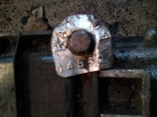

gerbox plate
this one is not from mine car but from gearbox i would like to get for my R4
number that is written in a circle is gearbox code
number written in line is production number of the gearbox
