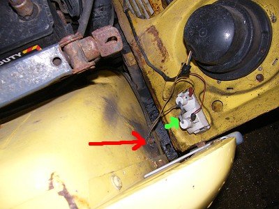

Bad earth where the earth wires from the bonnet and the wire from the cabin and the battery meet on the front of the RHS front wing is the only think I can think of that might cause the lights or the heater to affect another component. The earth does get bad. It's held by one bolt onto the front of the inner wing. The bolt is difficult to remove (rusty) but could be worth replacing and the connections and wing cleaning up for a good contact.

Should be a wire going from the back of the alternator to the RHS front inner wing. A good first step would be to remove the bolt with the big red arrow (your car might not have the arrow :D) and clean the wing with sandpaper and the connectors with wire wool, then bolt them all back up together with a bit of petroleum jelly to keep out the water.
Another thought. If the problem was just indicating to one side the metal strip behind the indicator with the green arrow can corrode and fall off causing odd problems.

hurrah. No more scruntching!!!! my car has working indicators again. I checked all the earth connections I could find, tighten them all and redid the indicator ones... (there also was a diconnected one from the dynamo) and it all works perfectly!!!
