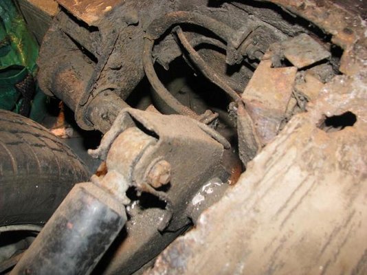

The thread on the bolt must go outwards or the rear brake compensator housing will be modified like this when the vehicle is loaded !

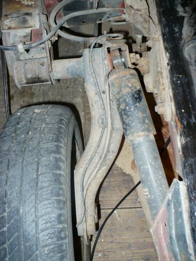

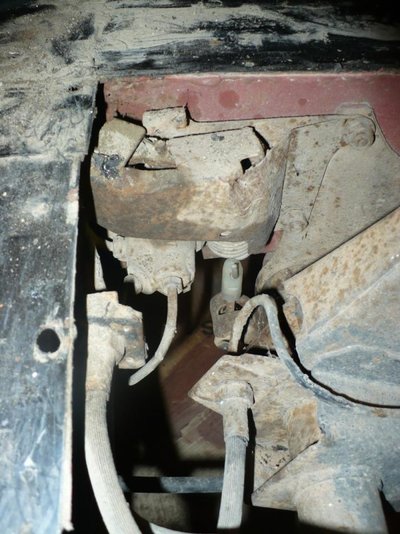

Hera are some photos
crushed housing
bolt in "wrong" way
I was always wondering why housing of rear compensator is demolished.
Now i know why!
I never thought of that but I wonder whether that's also a problem for the cast iron swingarms. Mine has the dampers attached differently.
