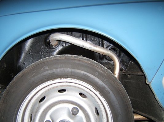

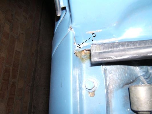

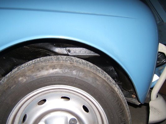

Anyway ,I have started to seal the windscreen as you suggested, but also I have found a couple of openings on both sides of the wings (see pic) , and I am wondering If I should block these with silicone to stop the water cascading into wing...(bad idea?)
Also my 1986 GTL has a lean, .....it seems much higher on the passenger front side -see pic- than the driver's frontside. Could changing the shocks,or tinkering with the leftside suspension bring down the passenger's side ?

The points you describe on the wings are precisely the points at where the putty had perished on my R4GTL and from whence water was gaining access into the drivers side footwell, the drivers side because as with your R4 mine leans to the drivers side too, (known as the R4 stance apparently, they tend to settle on the drivers side, doesn't affect the handling as far as i'm aware!), I put fresh dum-dum putty in and hey presto no more paddling pool.
Regarding the 'stance', i'm a great believer in if it ain't broke don't fix it, plus i've replaced the shocks all round and the 'stance' remains!
If you do find a way of curing it without a whole ball of trouble, would you be so kind as to let me know how you accomplished it, as it would be nice to see the car level at the front one day.

The holes in the top of the wings are to drain water from the rear of the bonnet and roof gutters into the wheelarches. Blocking them would cause puddles.
Many Renault 4s lean to one side. Normally repairing the rust around the rear suspension mountings using a jig cures the lean. You can find out whether the lean is caused by the front or rear suspension by putting a piece of wood across the car at the front and jacking the wood in the middle, preferably with angle iron inverted on top of the jack to give a point load in the wood. If the car leans after bouncing the suspension it's the rear suspension that is causing the lean. Jack from the rear of the car too to check the front suspension.

These holes are actually drain holes for all the water that collects from the roof via the gutters! (it would otherwise fill the gutter between the bonnet seal and windscreen). They should not be blocked,but since this area is a major "meeting point" (body,wing,inner wing,triangle panel!!), it is number one area to develop a leak. Even worse if the R4 has been carelessly repaired there using body filler (after some time it cracks,trapping moisture...the rest is history). Roodini, I think you sealed some crack on the old sealing material "accidentally" when sealing these holes,that's why the leak stopped. But the "correct" repair can be far more troublesome as you should remove the front wings,then reseal their rear joint etc... anyway,it seems that making a R4 watertight is the hardest task...
It seems that your R4 needs its ride height reset. In my opinion its due to torsion bar sagging. It is not a good idea to use the wing as a measuring point. For years I have used the factory measuring method (chassis to ground minus wheel center to ground) and it always gives me excellent results. Renault advice the use of some special "scales" to ensure equal suspension force on each wheel,but I think it is unnecessary even when starting with all torsion bars out of the car. To overcome driver's side sagging a famous trick over here was to set both wheels of this side 10mm higher (actually permitted by the factory).
