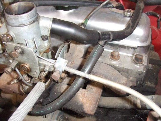

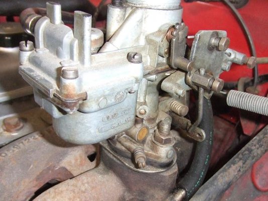

Hello folks!!!
After some months since I bought my R4 (845cc TL year 1984), a couple of days ago I discovered that my carburettor is a Zentih 28IF V05078A.
On Haynes manual and on this tabel that carburettor is associated to 688 (1100cc) engine.
Furthermore, I don't know which kind of engine is under my bonnet car since miss the plate.
In the vehicle registration is indicated B1B D7 but I am pretty sure that has been changed because B1B engine uses a Zenith 32IF and the year marked on my engine is 1986.
So, the questions are two: to give a "name" to my engine and understand if the carburettor is right.
Here some pics of my engine. Just for information, the distributor is a Ducellier R287D83 (525424A) and on the inlet/exhausted manifold there is the code II2 (or 112) - 3539453.
Thanks a lot for your help!!!!

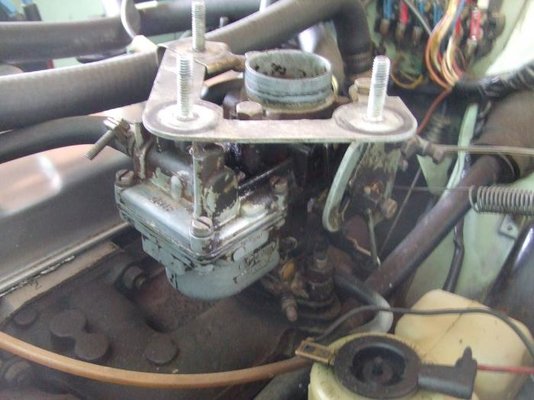

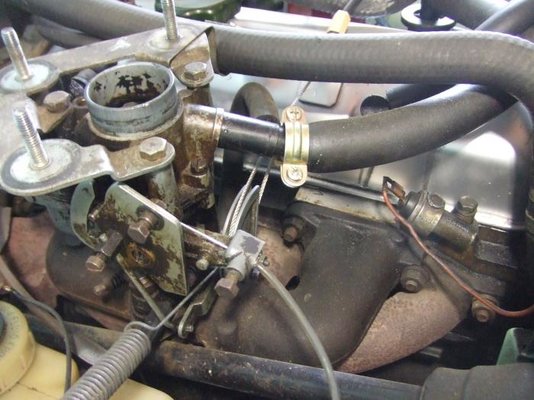

Hi Ramblers
My red 1983 845 has Zenith 281F carb with number V05 075B and its an 800 engine.
My green 1980 1100 has Zenith 281F carb with number V05 078A and its a 688 engine.
I took some pics remember the red car is the 845. Have a look at the rocker cover on the cylinder head. Its quite narrow- the same as yours.
The green car is the 1100 and that rocker cover is practically the same width as the cylinder head.
When you take photos you realize how dirty your engine is so guess what I'm going to be doing tomorrow
