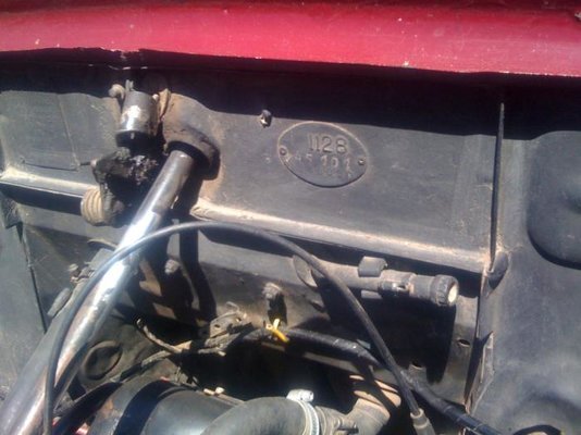

Ndelilio Nnko Enthusiast Messages 182 Location Arusha. Tanzania. EA Oct 16, 2013 #1 i dont know the function.of this pipe in my r4, i change water pump.but my r4 radiator still boil water and sometime it heat? can anyone help m out?? photo-11.jpg 47.4 KB · Views: 63
Tripyrenees Enthusiast Messages 391 Location Luscan, France Oct 16, 2013 #2 That is the bleed pipe coming from the highest point in the cooling system (top of heater matrix) Run you engine and unscrew the end, air will come out and the very warm coolant. Should fix your issue.
