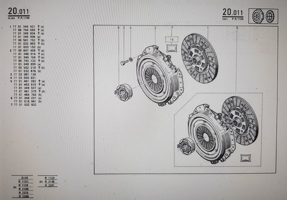

Does anyone know the part number for a clutch ( r4 1.1 gtl 1985)
This page should help:
These links will give more info on equivalents:
You can get a complete QKT627AF kit very cheaply here:
Thanks Keiths, it's a clutch it's gone to a garage. I was going to go and start rummaging in the shed as I have a lot of old new stock parts but the links provided by Andy McGhee saved the day.
Let me tell you Andy that you are the most loved person in the world by our family tonight.
