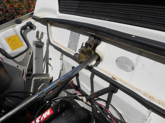

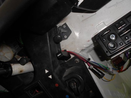

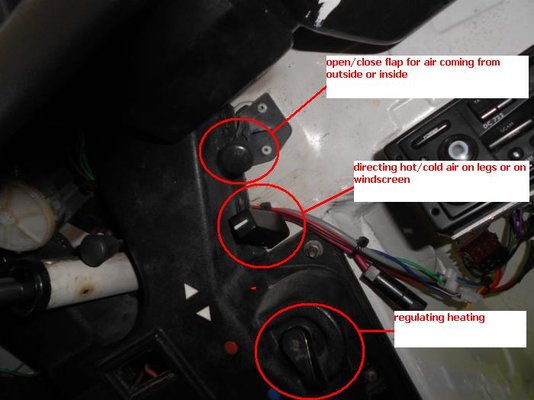

What is the purpose of this valve like thing coming out of the bulkhead? Connected to this knob next to column.
Jonathan is correct its to bleed the air out of the heater which is the highest point of the cooling system.
Thanks Pepper :)
Thanks. So how does it work? My heater stays hot on both hot and cold settings. Could be air stopping circulation. What does the internal knob do?

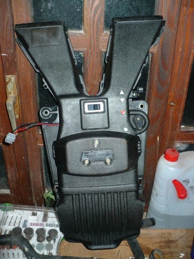

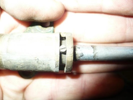

Here is picture of heater from inside. That nob that you see from cabin is inside left hose
Valve elements
Explanation of levers and nob inside the cabine
Thanks. Sorted.The knob is pulled out to let air in however the valve seems to be jammed solid on hot setting. I removed the two screws that seem to hold the cover on but something is holding it on at the top. Will it be a case of soaking the valve in plus gas or will it need replacing. Will the whole heater assembly need to be removed to access the valve? Any advice will be appreciated.

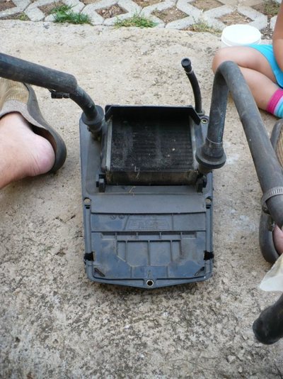

Here is front view of that panel

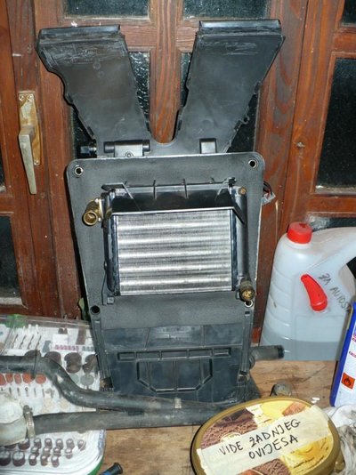

And here is back view of same panel. As you can see valve is accessible without further dismantling

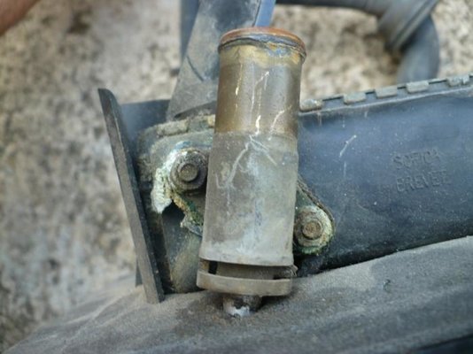

Here are two M6 nuts that are holding valve in place. Be gentile with them because they are probably stacked. Also if they are original one then are made out of brass and are very soft.

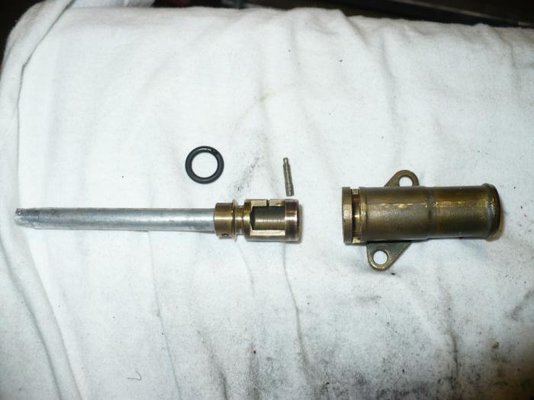

And here is bolt that is holding valve together. Unscrew him and you can take apart valve. Picture of dismantled valve you can see in my previous post.
I have hold mine in alcoholic vinegar over night before taking apart. Cleaned it with toothbrush and fine sand paper. Changed rubber ring inside him. Also before installation on matrix have made new paper gasket that goes between valve and matrix.
