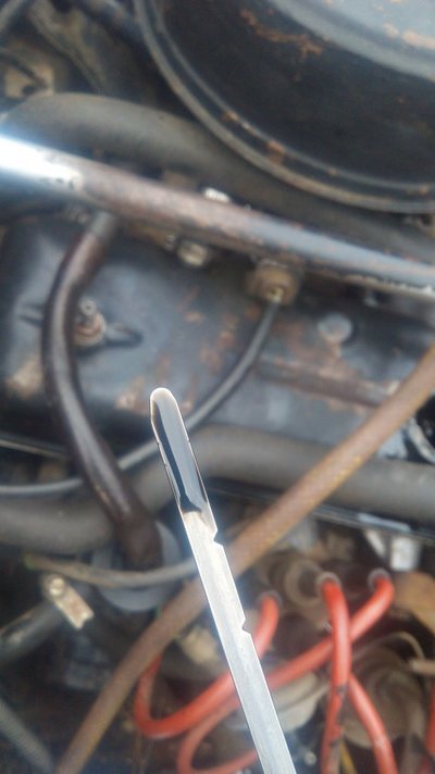

Helow....today l check oil and found its in below last level!!! :scared:
Also wire of altonetor is loss.. Not connected so betry wasn't recharge well.
Before anything l will call my electrician to check wiring first....
Before anything I would put half a liter of oil in the engine...
