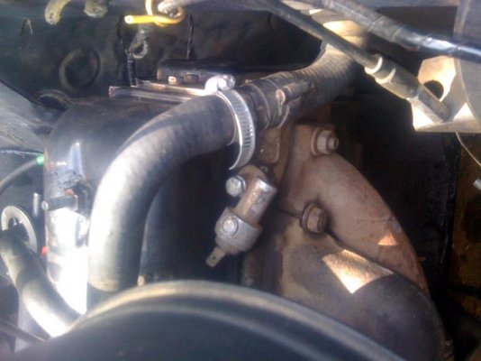

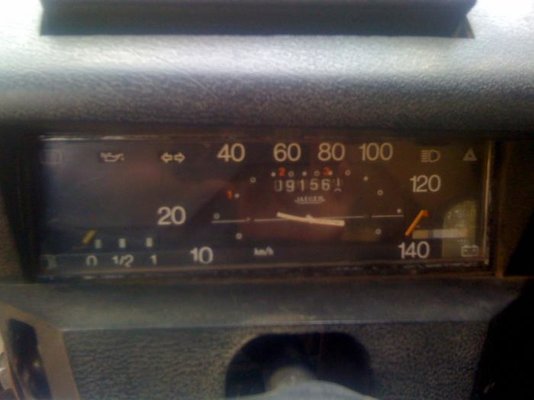

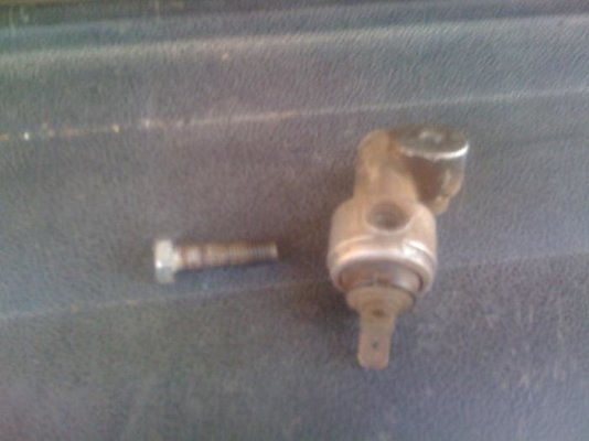

Ndelilio Nnko Enthusiast Messages 182 Location Arusha. Tanzania. EA Oct 21, 2013 #1 hellow....what is this thing? if its temperature indicator? in my dushboard there is no sign of temperature? can you help m....thanx alot..... photo-12.jpg 28.8 KB · Views: 111 photo-14.jpg 31.9 KB · Views: 107 photo-13.jpg 39.3 KB · Views: 105
jjad Enthusiast Messages 1,604 Location Herefordshire Oct 21, 2013 #2 This is the temperature warning light. It comes on when the engine is too hot.
malcolm & Clementine the Cat Messages 4,599 Location Bedford UK Oct 21, 2013 #3 It should be connected to a wire that comes from the loom behind the engine. It uses the same warning light as the oil presdure sensor.
Ndelilio Nnko Enthusiast Messages 182 Location Arusha. Tanzania. EA Oct 21, 2013 #4 Thnx. So that wire of temperature it can be connected to the icone oil in the dushboard?? Sorry for poor english
