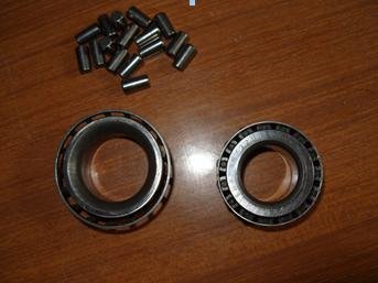

Hi I am currently changing my rear back pates and drums and thought it a good time to change the wheel bearings. However finding the right bearing seems very tricky.
My car is a 1992 1.0 TL (lhd) with bendix rear brakes. I read on a previous thread that the bearings are industy standard sizes. However only the smaller bearing has any form of code on "SNR 10R32004VC12 FRANCE 96C". So I without the code for the second I can't order from a bearing company.
I tried my local motor factor but according to his book both the bearings on each rear wheel should be the same size, which they certainly are not.
Does anyone know the size or a company to order from?
Many thanks
Tim
p.s should I replace the cones as well? And if I buy a kit will it come with new cones?

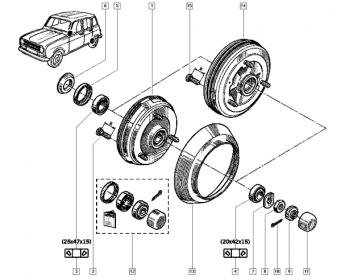

Great thanks a lot.
Here is the picture from the RENAULT parts website...
Kit no 12 7701460642 £46.57 plus vat
cheers
Andrew
