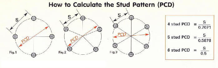

Bolts on R4 wheels are 3×130. Do not now what is on R12 or fuego.
You can ask seller to measure pcd.
If it is 130 than i am sure they will fit R4
Pcd is imaginary diameter of circle thatbilts are creating.
