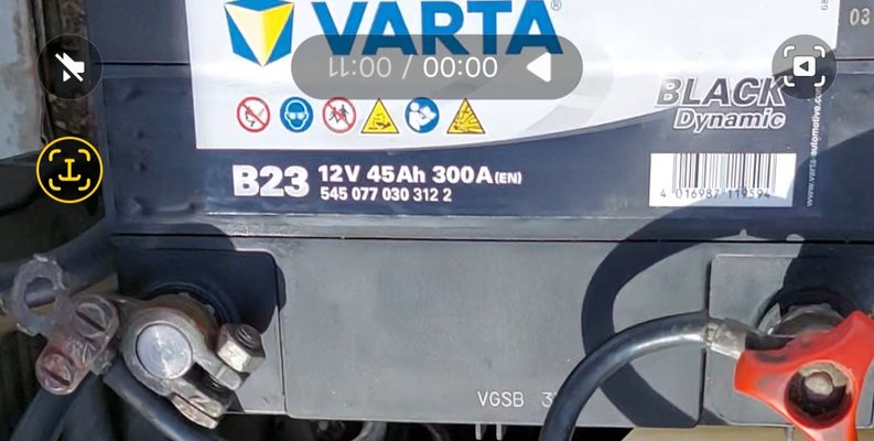

I bought my last battery a few day ago on ebay... 45Ah 420A Bosch, fits quite well and costed 43euros home delivered. ..

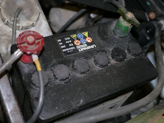

Hello, can I ask what battery you managed to source to replace the UNIPART GBA3048?
The R4 I am dealing with has the same UNIPART battery and it's flat, so I need to find a replacement for it that will fit the tray (I don't think these UNIPART batteries are still being sold?)

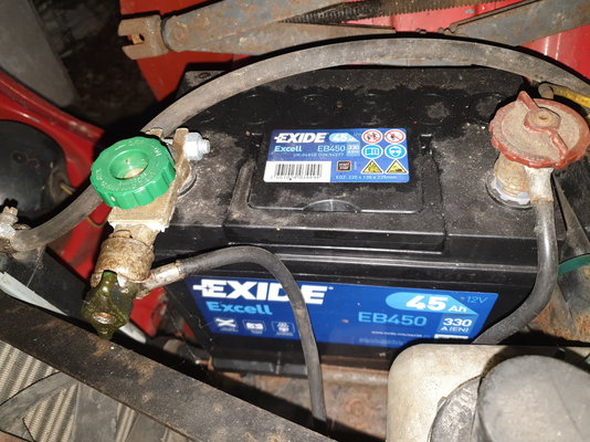

I bought the Exide EB450 last time. Terminals are the right way around and it has the tab at the bottom for the battery clamp.
The really useful thing is to buy a battery disconnect switch (the green thing in the photo). Twist the knob to disconnect the battery if you aren't using the car for some weeks. I have one fitted to the MGA and it always starts after winter and the battery is 20 years old. Flattening the battery will kill it but it can't discharge if it is not connected..
Hi, thanks very much for your response, it's really helpful.
I have just found the Exide online, thank you for sharing the photo and the information.
And that sounds like a smart move RE the battery disconnect switch too :)
