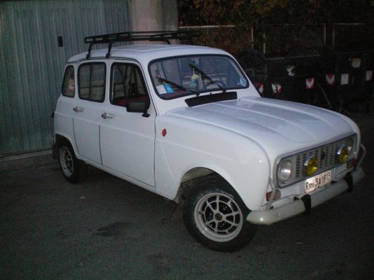

I have those jante on my quatrelle, they fit well and look even better.
The "5" ones are just a bit larger tha the gtl ones, so the 145 tire is "stretched" and the front-left wheel occasionally rubs on a silent block...

Mine were from a r6, but I do not know if they where robbed from other car previously... I can use only 145 tires on them because italian laws are restrictive. On my documents there's written I can run with either 135R13or 145R14...
In the shop they had no problem fitting tires, just had to use inner tubes because, they said, the wheel was old and not suitable for tubeless... I am not able to judge by myself...
