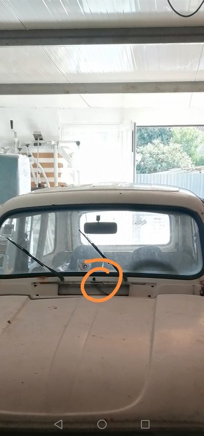

Hi folks, just spotted that the twin jet, black plastic, windscreen washer jet has broken in two! Looks like aged plastic in UV troubles again.
Anyone got a good (or new?) spare they could drop in an envelope please? I can transfer monies via bank transfer or PayPal.
It looks like it goes through the scuttle into the behind dash area. Is it a push-fit? Is there any dismantling required to reach the tube fitting behind the dashboard?
Many thanks!
Just pop into nearest Halfords or other such ,measure hole and get one that fits Plastic ones are best ,that way you wont damage the paint when pressing into hole)-pressfit as you say.While at it buy 30cm "copper"brakeline, cut plastic hose from washer reservoir to nozzle where it is closest to the hose going into heater-matrix. Curl 5 or 6 rounds of the copper-line around the heater rubberhose stick on plasticline(s) on each end and Hey-Ho you'll now have heated screenwash which is much more efficient... -R.
