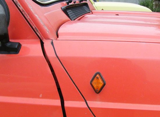

They are on nearly all Italian r4s
Took this picture last year, somewhere around Venice.
