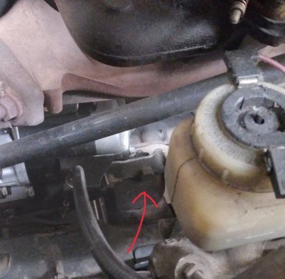

Yes, that seems to be the case. If I'm not mistaken, I should see the bracket here:
Regarding the link you posted: that would be perfect, thank you very much. Are there any difference between engine versions (e.g. does it matter that my engine is a 950cc one) or are those brackets all the same?

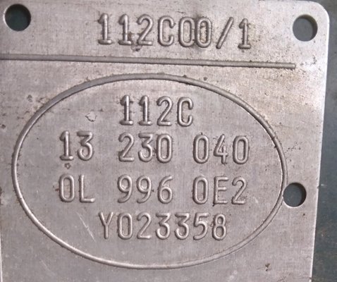

Can I ask what the oval plate (under the bonnet) number is on your car? I'm guessing that if it's a 956cc, it'll be R112C.
The bracket in the link I posted is for 'Cléon' engines (mostly 956/1108 engines, but also 852 in Spain). Renault 4s with engine of 845cc or less have a different 'Billancourt' engine, and the bracket is different on these.

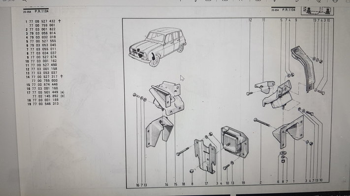

This is the relevant parts page for Cléon-engined cars:
Sure, it says 112C, but with no "R" in front.
Here's a picture of the oval in the plaque for completeness:
I'm afraid I'm not very knowledgeable about the engines in my car as I haven't gotten my hands dirty with it (yet), so if you could teach me how to read this plaque I'd be grateful.
Jack
As your plate shows, it's 112C (without the 'R') - my apologies!
