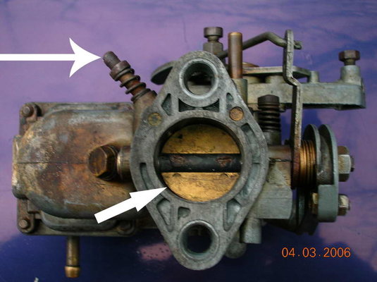

I visit some carb service..but here in Serbia it is hard to find someone who knows. Some of them sad..hm...my english is not so great but I will try ..they say that there is a space between main throat and panel..hm.panel that moves when you press accelerator pedal..I hope you follow me ..and there is a air suction .
I tried...many thing but no result. And..i read posts about Zenith..and...I have few questions..first you mentioned screew with spring..hm..there are two..on is for idle speed I think !? If I am right other one is for mixture volume ? Let's say it is . I tried to screew f all way but no result..just a little bit change...and then unscreew it totaly..and then engline stops.

Now can you tell me which screew is for mixture ? Is it one with arow pointing at it ?
The one with the arrow looks like the mixture screw.
