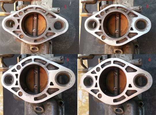

Maybe still some airleak at the base of the carb.
Get a really flat surface (thick glass plate) a sheet of sandpaper 400 then 800, and flatten the carb foot in figure 8 movement.
