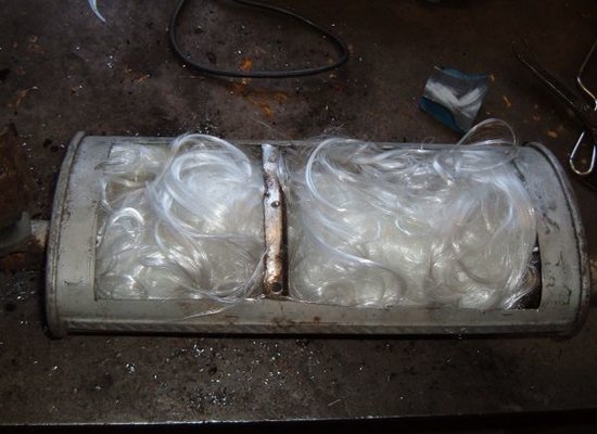

Robert reported that changing the exhaust silencer on his R4 from a random aftermarket one to a Bosal one improved performance. Just for fun we cut one apart this morning to see what's inside. It's a restrictive design - couple of perforated tubes passing through rockwool in the end chambers and crimped at the ends in the central chamber.
Wondered if anyone had noticed any performance improvement by swapping the exhaust silencer (or whole exhaust)? Thinking it could perhaps be the next restriction after the carburettor.

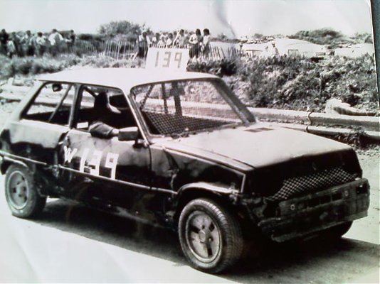

found an old photo probably 1993 (thought i had engine pictures )
have still got engine though
now you know what the 139 on my user name is about
paul

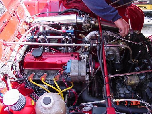

i've just come across an old Retro Cars article on the C1J engine, quoting 350 bhp from a fuel injected Group B R5 Maxi Turbo from about '86, and referring to a company called BB Performance Tuning in Colchester, who have quite a bit of tuning experience with this type of engine.
does anyone know if there's an easy route to fuel injection on our engines?...perhaps a bike throttle body with just the right sizing/ hole centres etc....probably, injectors from these new injected scooters may be sized best?
ade
The R5 Turbo 2 had Kugelfischer mechanical injection, something like a low pressure diesel injection.
As far as I remember it worked at around 2,5 bars boost pressure, thus these HP figures.
I think fuel injection would not be too difficult to be fitted on the C1E. If you want to have individual throttles they can be made or better (but more expensive I guess!) fit throttle bodies from a motorcycle, they are individual, not paires, so their spacing can be altered very easily.
But of course you will need an engine management system with a blank ECU. I think the cost of the whole project would be too high to be justified... however take a look at what I found in my photo archive:

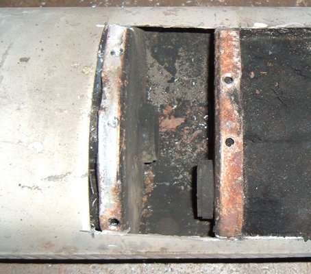

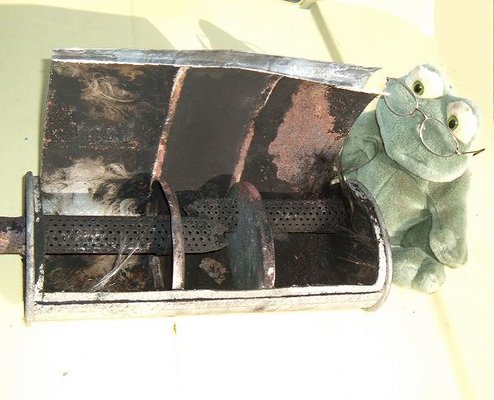

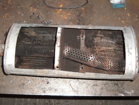

My car was fitted with a Bosal exhaust. Cut one open to look inside and it's different from the one in the earlier photos - no crimped ends of pipe, but the changeover section looks very small.
I modified mine to make it straight through (not very pretty)
Next filled it back up with stuffing (and a little stainless wire wool around the pipes to help stop the stuffing blow out)
Welded a cover plate on to seal it back up and went for another performance test. 70mph again - success! It sounds a bit funny though - perfectly quiet, but there's an entertaining rasp on acceleration and over-run.
