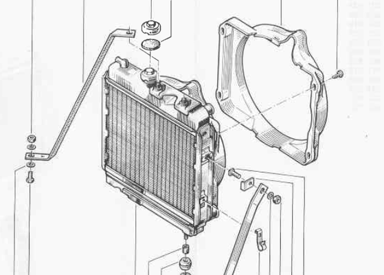

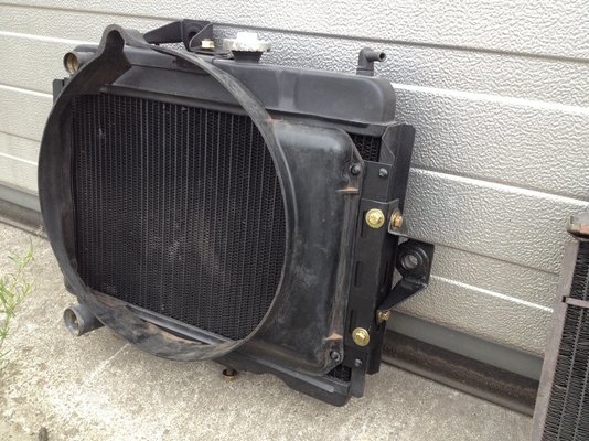

I don't know if thats the correct word for the plastic part that is fitted to the back of the radiator as in the photo below.
I'm having difficulty getting a radiator wide enough to accommodate the fan shroud.
Its very frustrating when some websites advertise radiators that are no longer available when you want to place an order.
It's even more frustrating when radiators that are advertised as being 390mm wide are in fact 350mm wide
Today I was told that the shroud is not necessary. I think it is otherwise Renault wouldn't have put it there.
Any thought please?

Thanks for your comments Paul. The radiator on the 845cc is far smaller than the GTL so I believe that the shroud is there to concentrate the air flow through the radiator. I want to keep mine on but just need to find the correct radiator at a reasonable price
From the diagram above above, you can see that the whole back of the radiator is covered by the plastic shroud.

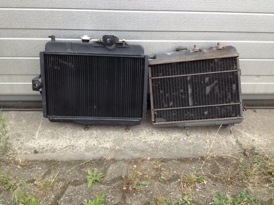

Mojobaby, If you can't find a fitting radiator you can adapt the Fan shroud to fit the radiator. I did it for my project as wellIMG_0512.JPGIMG_0514.JPGAs you can see the new radiator is much wider than the old one. I simply made a new frame om the radiator to fit the shroud. For a hotter climate you benefit from a bigger radiator to
thanks Harbourseal, you have found the perfect solution.
I seem to have the reverse problem --- my shroud is wider than all the radiators that are offered by the usual suppliers.
I might have to follow your example and make a bracket but it may look a bit strange.
I did buy a radiator from Oscaro but sent it back because of the size difference
At the moment I am trying to find a smaller shroud so that I can buy Reidalpine's radiator
and another one, Reidalpine!

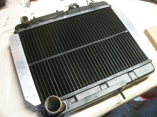

My new radiator arrived today and as I expected, it's smaller than my fan shroud. I'll probably have to adapt it the same way that Harbourseal did in the above photo.
Only in reverse, as my radiator is smaller and not wider like Harbourseal's.

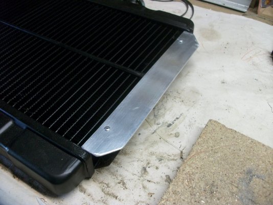

So here's the first step.........a 35mm wide strip of aluminum pop riveted to each side
The radiator is from PieceAuto24 in Germany-107Euro plus 10Euro delivery and comes with the rad cap.

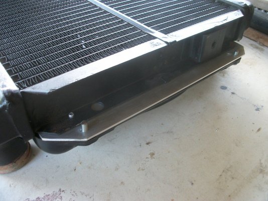

Plastic fan shroud has now been attached to the aluminum side strips
View from the back

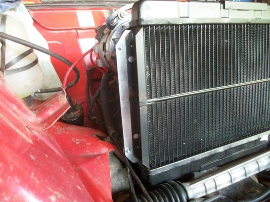

mounted to the engine...at long last
The radiator itself seems to be quite solid and well made, but the cap that was supplied is cheap quality. I might use my old one
