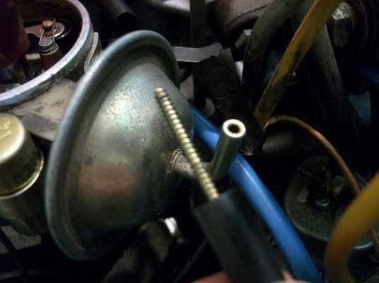

After reading a few posts regarding vacuum advance units, I decided to check up on mine on my GTL.
I took off the distributor cap and sucked and sucked on the pipe from the carb side, but nothing moved. When I disconnected the pipe at the vacuum unit, I discovered a screw blocking the pipe.
I have previously disconnected the pipe but have never noticed the screw, as it was pushed quite deep into the rubber pipe.
I presume that the vacuum unit is faulty/broken. Nothing moves at all in the distributor when I suck on the pipe, even with the screw removed.
My car runs perfectly at low speeds and high speeds, I have no problem at all. So my question is, should I just let sleeping dogs lie? It seems impossible to open the unit to check on any problems inside that I might be able to repair.
The car will be much more 'nippy', smooth and economical on anything less than full throttle with a functioning vacuum advance.
You can get pinking on full throttle if the ignition is too far advanced, but that isn't so much of a problem on part throttle so the vacuum advance advances the ignition by up to 8 degrees or so on part throttle. That gives you smoothness, a lighter sound with less booming, makes the car go faster and improves fuel economy while cruising.
I would try to fix it. Looks Ducellier and replacements were available but not so much any more. Something that fits would probably do the job as there is adjustment for the vacuum advance inside the distributor.
Thanks Malcolm, sounds good so I'll make some enquiries. There are quite often 2nd hand distributors advertised on Le Bon Coin, so thats another option.
