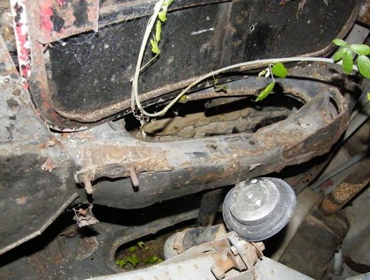

I am about to do some restoration work on a 1975 R4, on which the lower part of the right front chassis side member has rusted badly. Does anyone by chance have a repair section for this? Or a chassis from which that part can be cut off?

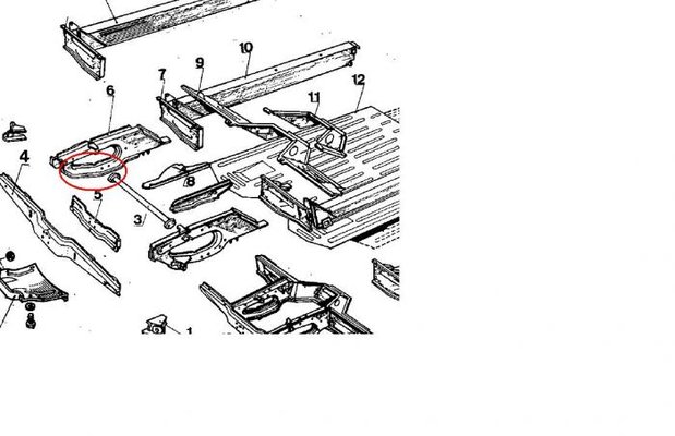

I mean what I marked on the drawing. It is rotten up to the part that attaches to the floor. It's no problem if it has surface rust or minor dents, as far as it does not have any rust holes. I trust you, and your experience in R4s, so if you think it is OK there is no need to take photos.

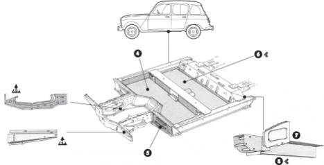

Angel, it wasn't that long ago that the complete front part of the chassis was still listed by Renault - at least the GTL part was available - not sure if it's the same as a 70's chassis. May be worth looking into.

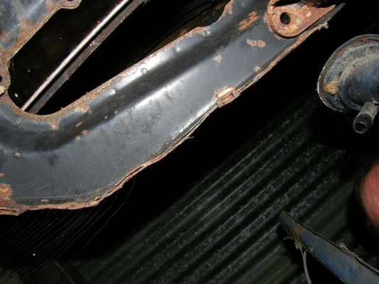

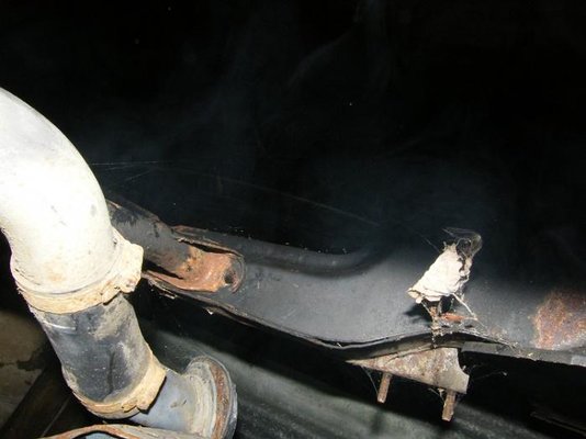

I don't have good access to the chassis but the chassis side-member looks OK apart from jacking damage. There might be signs of rot near the triple skin part under the suspension mountings. Lighting is poor where the chassis is stored so it's difficult to tell. They normally go there.
Would be better to replace the whole section rather than cutting near to the suspension. Mine will be rusty where the floor panel covers the chassis - they all are, and my chassis is missing the outer front crossmember panel.
