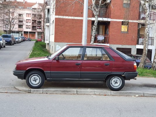

1984 Renault 11 GTL
Hello! :waving: Long time, no see :D

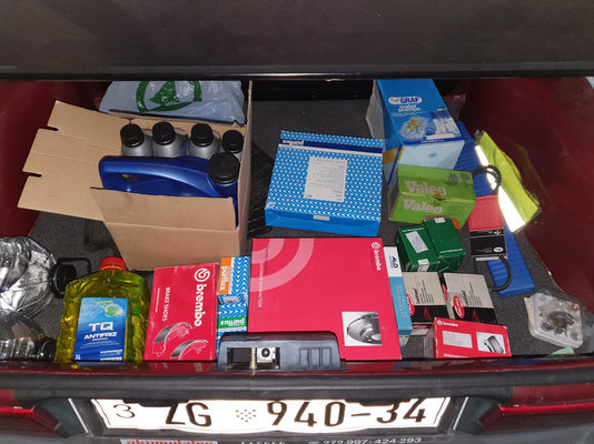

Anyway, nothing much is done here, except that radiator and occasionally turning the engine on. I got all the parts needed so tomorrow it goes to the mechanic, on Friday on deep cleaning and polishing and then MOT. After MOT, I have in plan to clean all the rust underneath because car doesn't have license plates and it is in the public garage so it is quite tricky to get all things done there while is not registered.
As you can see, all the parts are ready. :cool:
So, there is engine oil and the filter, gearbox oil, brake oil, antifreeze, water pump, belt, fuel pump, fuel filter, air filter, carburetor repair kit and completely new front and rear brakes. I don't have in plan to change anything in the suspension for now because it is all original and doesn't make any sound so I would like to keep it as long as I can.
If you think I am missing some parts or it will be good to change it, feel free to tell. Until next time, have a nice day :waving:
There are 4 different brake shoe and cylinder setup fitted with bendix and girling versions both changing designs in 1986 hopefully you have selected correctly

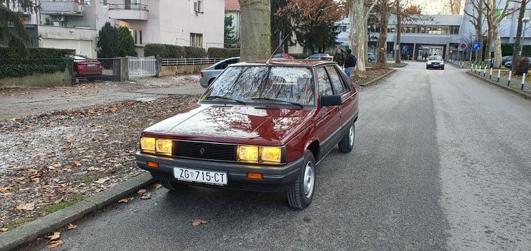

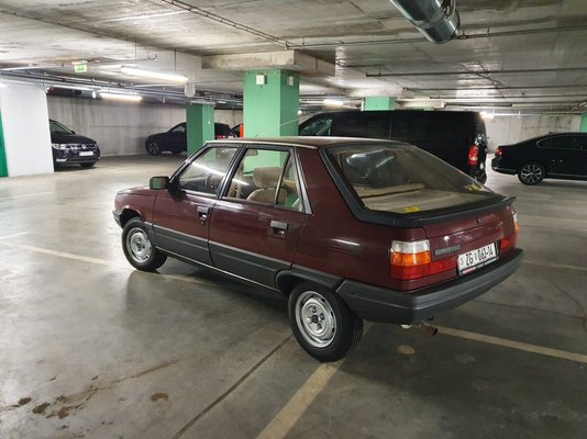

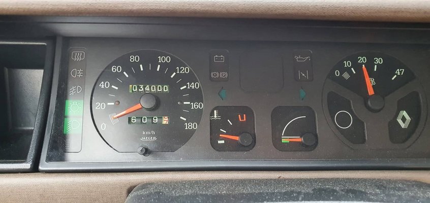

Hello! So the mechanical part is over, all liquids are changed, new brakes, new sparks, ignition set, carb cleaned, new feul and water pump, etc. Car is running perfectly at idle, it is nicely speeding up, but a little bit hesitant on slight touch of the pedal. Anyway, here are photos so enjoy :D
That is all for now, I have to pass MOT next because it will be easier to drive it around on polishing and other things that should be done. So, until then, this is about to be it.. See you guys :D

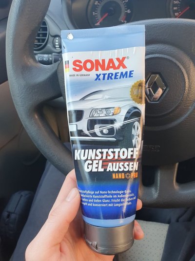

For some time I searched for the best solution to get bumpers and plastic trims back to origine. I did not want to do it with industrial fan because it does permanent damage for the plastic. So I decided to use Sonax gel cream made specifically for that kind of problem. It turns out great in my opinion, take a look...
87031440_2367929510164360_441040540834725888_n.jpg87045609_133033034681370_8412905802519543808_n.jpg87284822_1317273225123099_2342087851677581312_n.jpg87736600_2513760772274036_8285152193573552128_n.jpg
This is what I am talking about

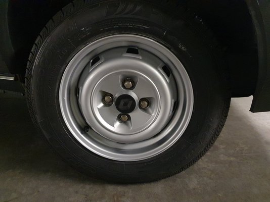

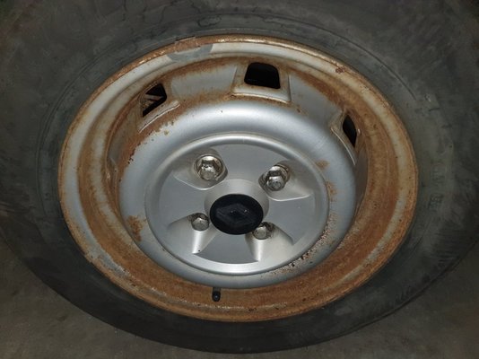

With nice spring weather (and that fu*king Corona virus :mad:) some nice things happened :D Wheels are sand blasted, protected, painted and baked in the oven, guess it should do the job :D I bought brand new Kleber tyres because old ones were 12 years old and egg shaped because the car stayed so many years on them. Anyway, here is result :whistle:
Before
After

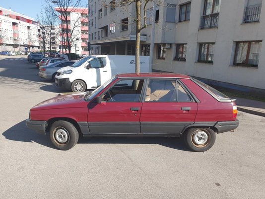

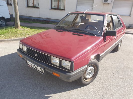

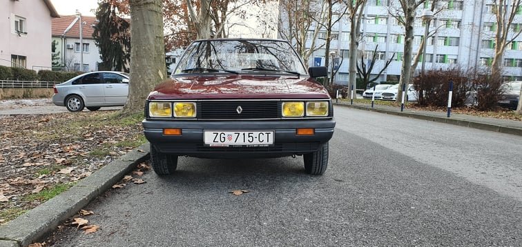

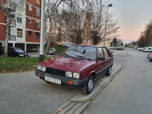

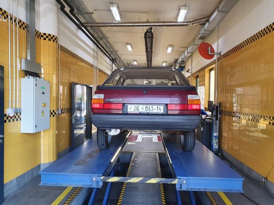

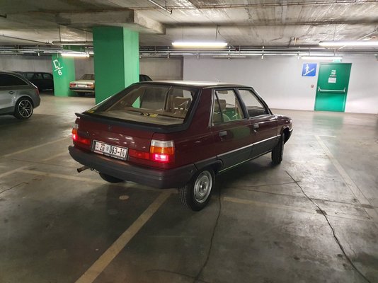

Yesterday I went to MOT station, and passed without any complaint. The ecotest was like when it was new :cool:
89056296_563606604363501_1611064343221239808_n.jpg89429869_2855000674593235_1256842005019885568_n.jpg89435975_1829048880563333_1228713018657865728_n.jpg89120785_621421811924778_6514203354841743360_n.jpg
So far, so good. The next thing is cleaning the interior and polishing. Then it will be ready for nice and easy spring and summer drives with Serge Gainsbourg singing in the background :artist:

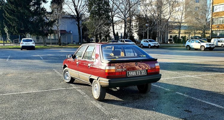

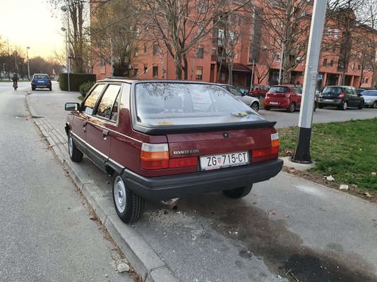

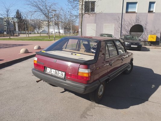

It was a big struggle inside my head, whether I will change the muffler or not. So I decided to do it.
But I was not quite happy with what I got because the exhaust pipe was too short and looked amputated.
But the underbody now looks perfect, just like when it was new.
The next day I decided that I do not want to look at this amputated pipe so i made new from original specifications :whistle:

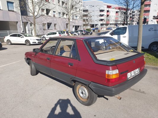

The wheels are repainted but the bolts were very dirty and that was making me really nervous so I cleaned and polish them. I did that by hands and would not recommend doing that if you like your fingers :o:D Anyway, now it looks like it should be :cool:

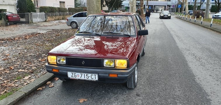

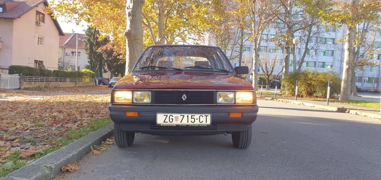

Hello!

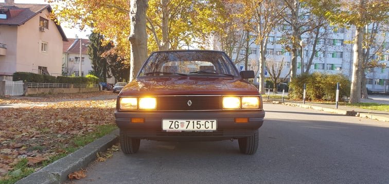

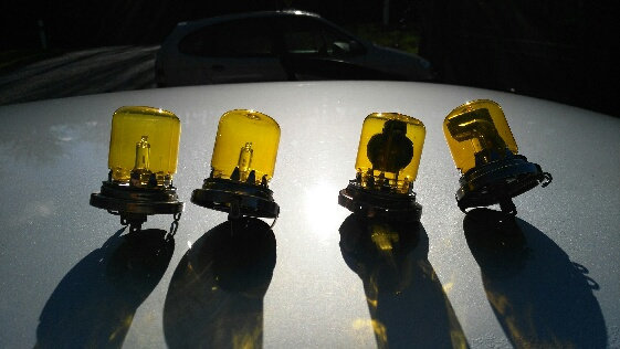

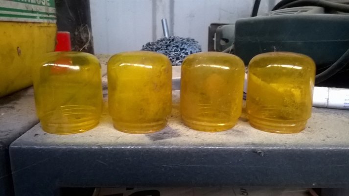

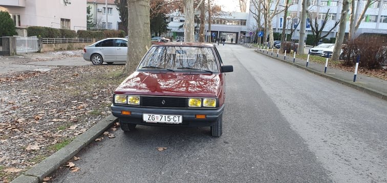

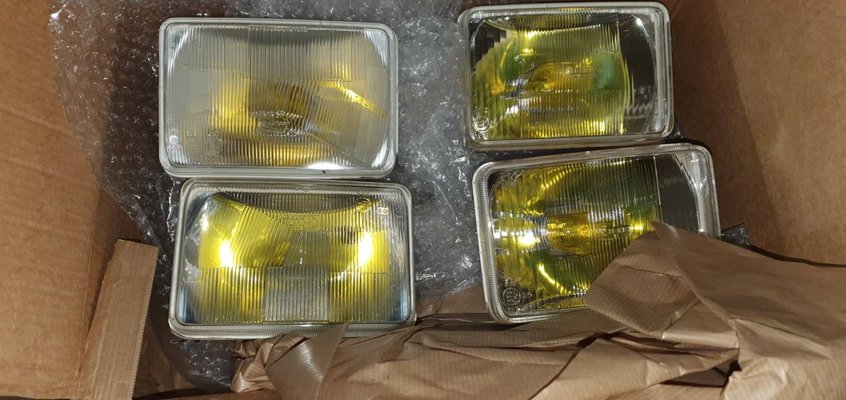

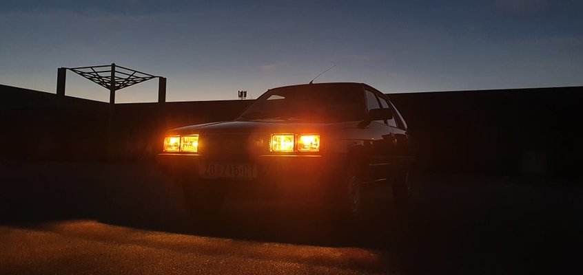

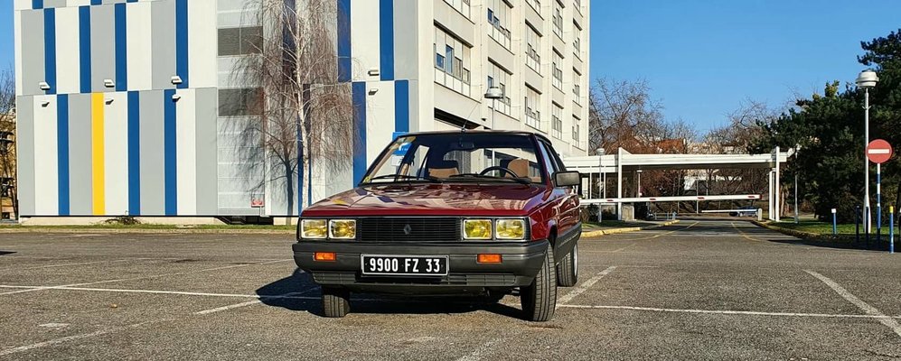

After a long time searching for yellow "hats" for the h1 bulbs and as I couldn't find them, I decided to buy yellow h1 bulbs. It is not the happiest solution because I didn't get the look I wanted when the lights are off, but it turns out great when the lights are on.
And one at night
With this yellow "hats"
I would get this look
Until I find them, I will have to satisfy myself whit this yellow bulbs...
