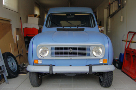

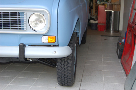

Today the new shoes arrived.
:D
With the choice of tyres I wanted to add a special and personal note to the smurfish little van.
The decision was between white sidewall tyres or some bad-ass (I apologize for my choice of words ;)) off-road-style ones.
As I couldn't find a place that sells the white sidewall tyres in the correct size it had to be the 2nd alternative...
I know it will be controversial seen, but I think, I like it.
And as the F6 is just a "fun-car" I can live with the inconvenience of having a cross-country R4.

Very nice choice! Personally I don't like whitewalls on most cars, let alone an R4.
What manufacturer makes these mud tyres? Are they 155/13?
Hi Angel,
these are offroad tyres made by Fedima.
The "official" (and imprinted ;)) size is 145/80 13.
BUT they are wider AND bigger in diameter than standard 145/80 13 ones.
I mounted the new tyres on one side of the car first and you could easily see that the car was out of level with the old tyres on the other side. :lol:
So in addition to the unique offroad-style look I will gain a little ride height. :D

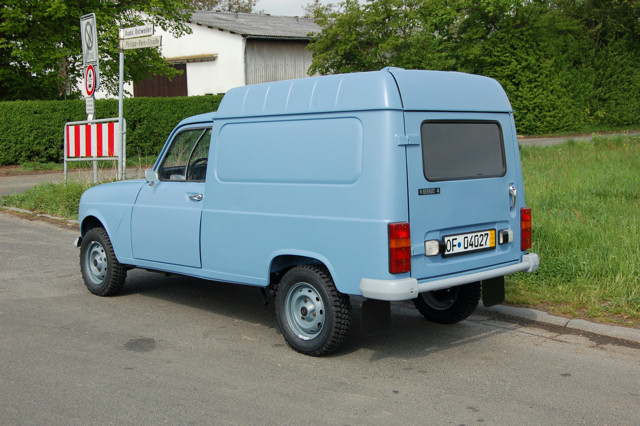

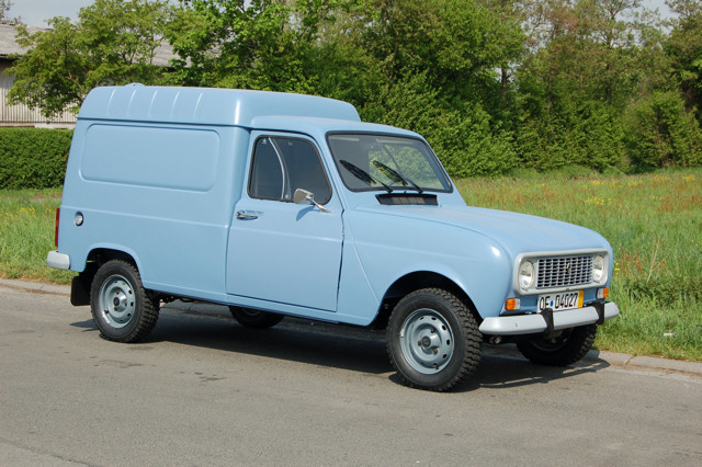

I got temporary plates today and was able to take the van for a ride.
On Wednesday I have an appointment with the officials to get the TUV (~MOT).
I had to re-adjust the rear brake pressure valve as the rear wheels locked too early. The braking now is absolutely amazing!
The ignition and the timing have to be adjusted as the engine misfires when hot and driven smooth and with constant RPM's.
The carb and the wheel alignment have to be fine-tuned again and the fuel gauge sender does not want to work - damn, I better had checked that before re-assembly. :mad:
Otherwise no problems so far! :D

I just want to let you know that I passed the TUV test without any problems this morning. :D
(Okay, we had to cheat a little bit to pass the emission test.) :cool:
The car is still misfiring and the idle RPMs are not very consistent.
(I still use all the old ignition components, but ordered new parts yesterday.)
So this last problem will be solved in a few days, I'm sure.
