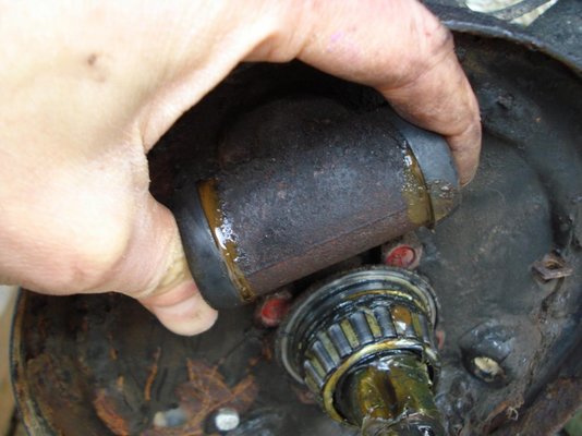

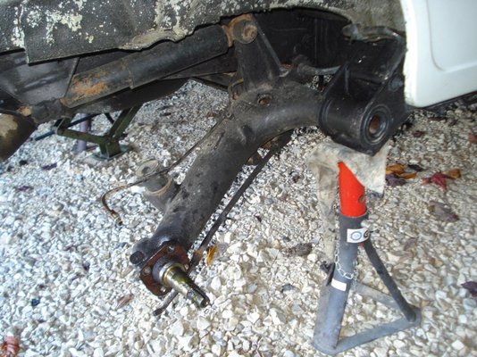

time passed since my last visit and I did some little things on my lovely F4; first of all, during the autumn 2013 I decided to change the rear right bearing which made a terrible noise during driving, especially in the left bends, so I opened the rear drum to change it... bad surprise :(

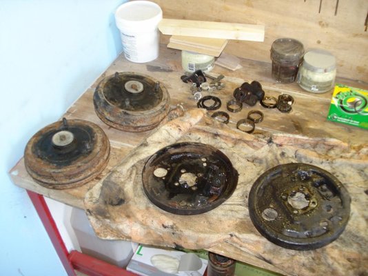

So I decided to change ALL the rear brakes parts and the TWO bearings, pfffffff, as every time you think you're going to repair and finish quickly, it became a real big job to do... :mad: :mad: So I dismantled all the parts:

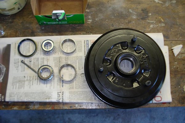

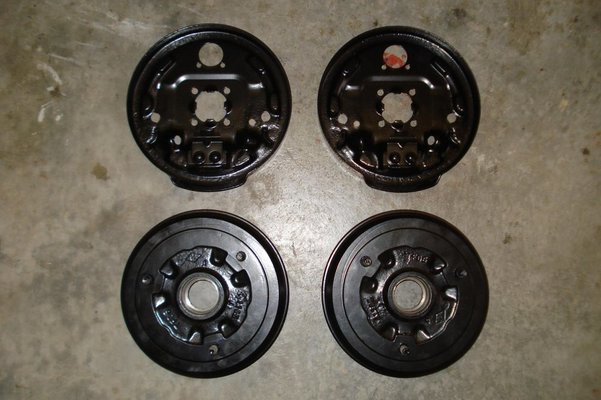

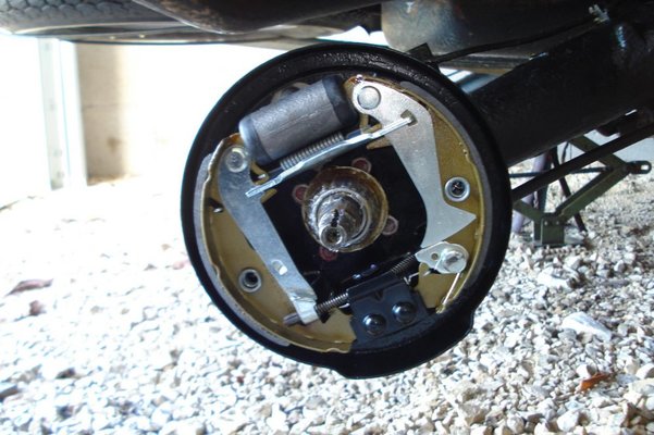

I gave my drums to a local company which made an epoxy coating, and I changed all the parts:

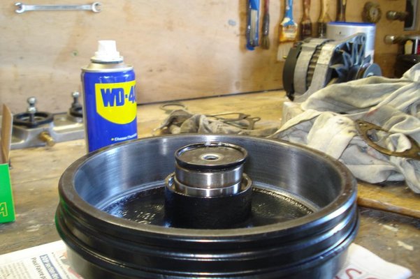

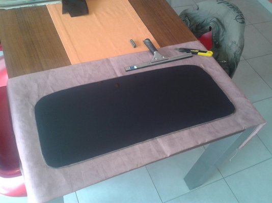

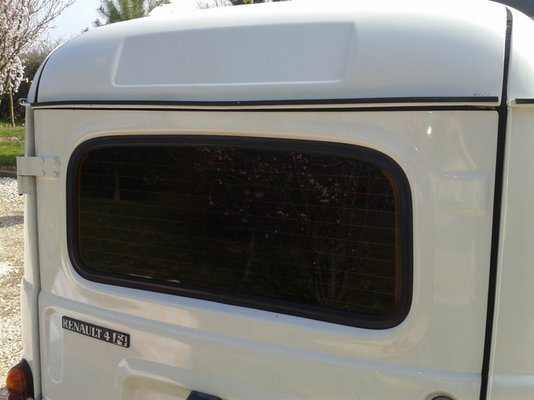

These days, several months later, I decided to apply a black cover on the rear window, as I did on the side windows, sometimes I have my mountain bike or tools in the car, I want to avoid people see what there is in the car...
What you see on the last picture in the window is not air bubbles, but a reflect of a tree with pink flowers :p :p

When you send your drums for epoxy coating did you have them skimmed inside too - they look like new.
Good evening :)
Azazello, it's a Prunus cerasifera Pissardii Nigra !!! Anyways, the company I usually give my parts made an enormous mistake on these drums for the first time !!! They made the epoxy coating outiside... and inside too :eek: I was so disappointed, before asking a friend in another compagny with lathes to sand the inside perimeter of each drum, this is the reason why they look like new ones :rolleyes:

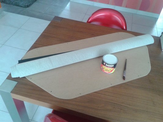

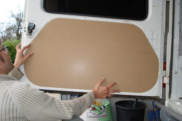

I finished this morning another little thing on my F4, contrary to some ones, I didn't have a panel on the rear door, inside the trunk, so I decided to build it myself, I bought a 3mm piece of plywood (not "plywood" in reality but I don't know the english word for "medium" :p) cut to the general shape of the part, then I took many time to carefully adjust and cut it to the exact shape...
Last monday I visited my friend Patrick who is an awesome saddler and he sold to me imitation black leather...

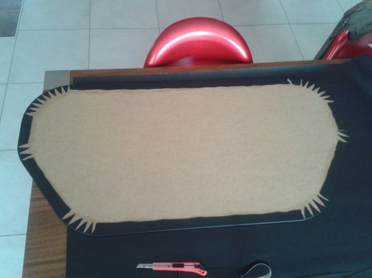

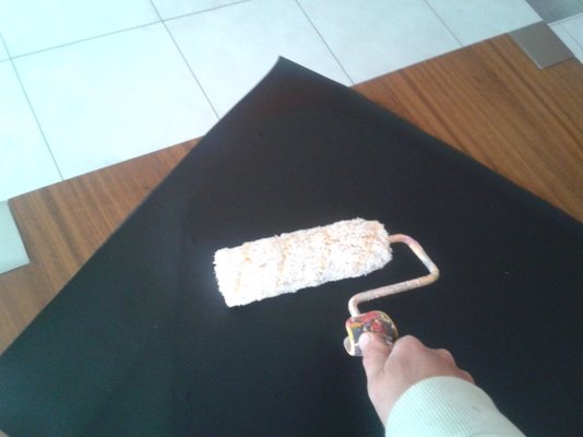

I sticked the panel and the imitation leather with "neoprene" (which is really difficult to work with...) and I waited for about 10 minutes before assembling the two pieces, I pressed the panel with a paint roll to avoid air bubbles between the panel and the leather:

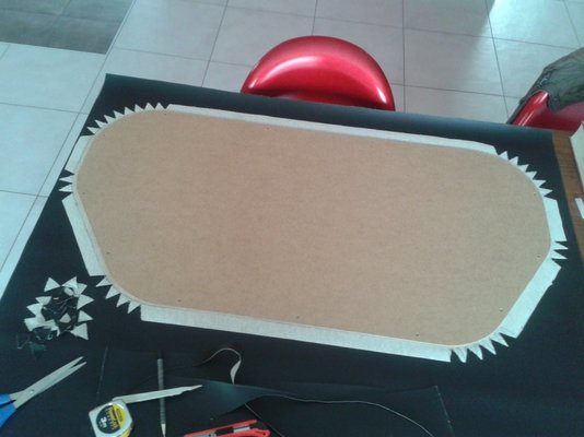

And I made little notches in the leather to improve the form in the edges of the panel:

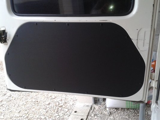

I chose to use visible staples from "Restagraf" and I fitted the panel on the rear door, the result is really good :) :) :)

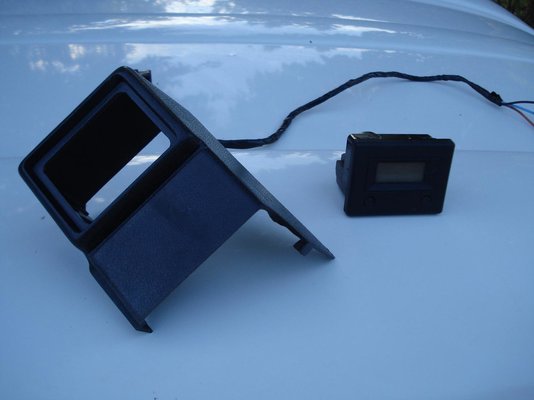

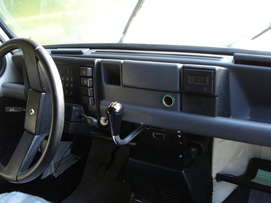

I fitted an accessory I wanted for a very long time: a clock from a GTL on the dashboard :clapping: It matches very well with the rest of the dashboard and it looks like a genuine equipment.

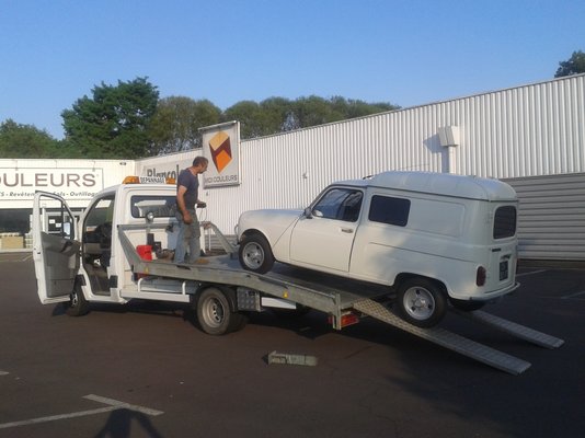

The only problem I've ever had with the car is a failed ignition capacitor, I had to call a friend with his tow truck !
