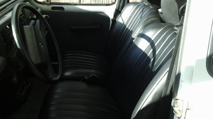

The engine is suspiciously clean for a 31 year-old car, but so is the upholstery, boot and parcel shelf.
