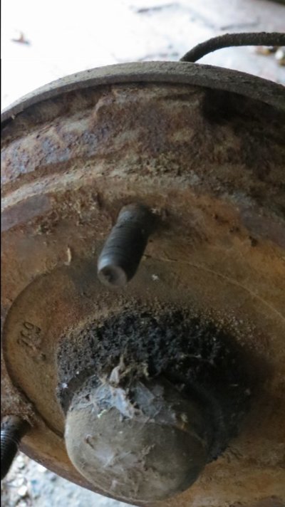

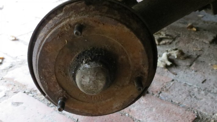

Can anyone identify these rear drums as Bendix ? Across the front flat part they measure 160mm. IMG_4475.JPG IMG_4476.JPG
Read above 160mm only one type bendix
That's why I asked I just wondered if measuring the FLAT section of the front of the drum was an accurate way to measure diameter. If so then my brakes are Bendix all round. Thanks
