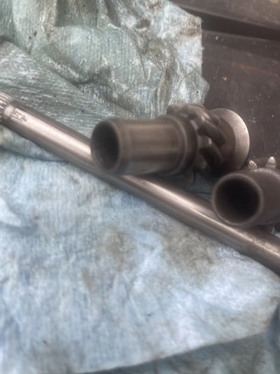

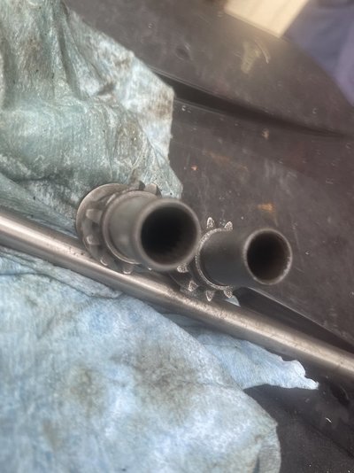

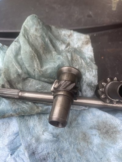

I need more help. I confirmed that the oil shaft pump was not turning. I then removed the distributor and gear and compared the old broken tooth one to the new one. For some reason the splines do not go far enough down or it’s just worn out.
I need a new distributor cam.
Any suggestions on how I can get one?
Many thanks in advance !
Bill
