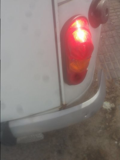

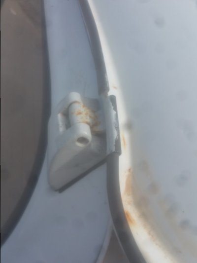

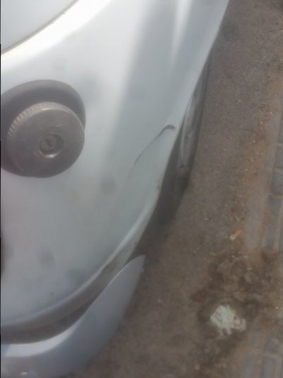

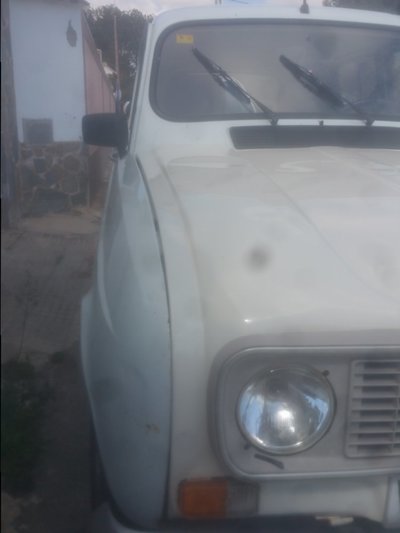

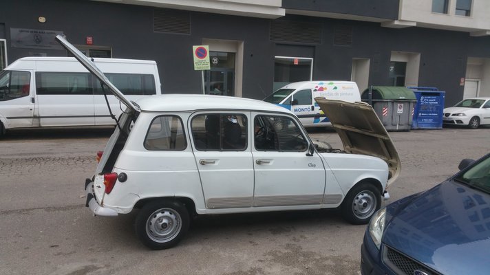

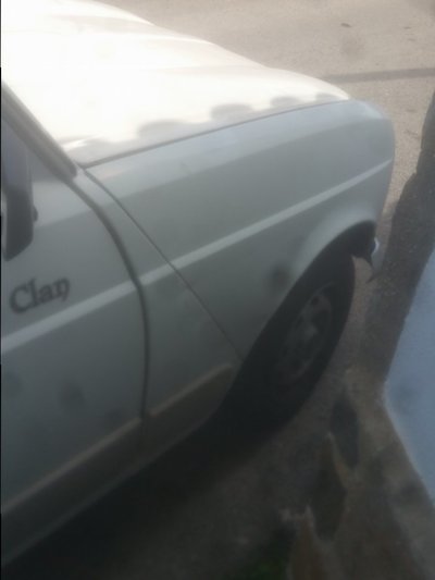

Ok.. So I need help with the paint situation. I have been to two well regarded body shops to get prices for my R4. I have under estimated the price of a full respray, including dealing with some minor dents nothing earth shattering were talking 1500 euro (1312.00 gbp for comparison). That's keeping the original color. What do you guys think? One of the shops is a British expat who does great work the other is an old school Spanish fella who has experience with Renault 4s the prices were within 50 euro of each other. I can feel myself reaching for the Tcut but preventing rust from spreading is also a concern. What would you guys do in my situation? Looking forward to hearing your opinions !!!!

Well the price you have been quoted is reasonable but the problem is it's hard to know what sort of a job they will ACTUALLY do for that. Unfortunately there are many companies (with profit and speed in mind) who will immediately reach for the high build two pack primer . This will give a good finish but a very unauthentic rounded one. Hard to describe but instead of looking like an honest little tin car it will look like a Dinky toy car made big with all the fine lines dulled and rounded. If your budget is very tight you might paint yourself? Getting a good finish is not impossible even with home style equipment PROVIDING. 1/ the preparation is meticulous 2/the rubbing down or cutting of the paint after its applied is considered part of the process . In other words if you get plenty on you can cut it back to give a great finish. This surprisingly can also apply to a hand painted finish
Thanks Jonathan, food for thought I feel an evening of googling how to paint bodywork coming along. Problem is I don't have a garage to work in. Also considering how long it will stay intact and unscathed once I shell out the money considering I live in Spain and the R4 has become my daily driver this winter.
I once painted Aystin Seven wings with cellulose paint applied with s brush. After laying off with the brush and s couple of days later I cut it back - the result was the same as if I'd sprayed it with no brush marks. There are YouTube videos of people doing similar with Acrylic paint
