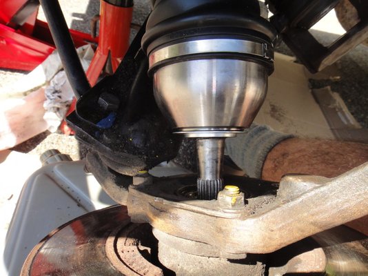

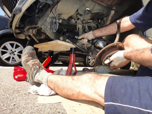

Again I sat under the car and carefully slid the end of the drive shaft back into the gear box keeping it level and straight. It slides in easily.
with the drive shaft inserted I then I pushed the drive shaft into the gearbox compressing it and got the wheel end of the drive shaft into the wheel. Its tight but not too difficult.

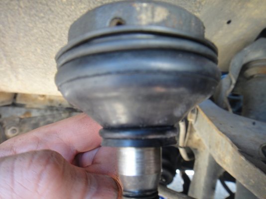

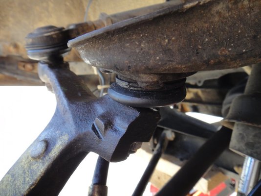

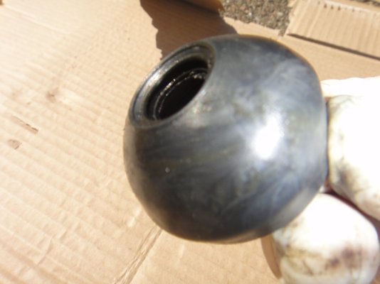

With the wheel supported again I turned my attention to the ball joints.

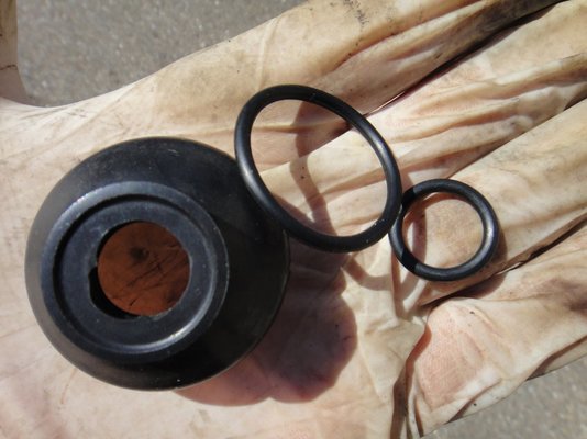

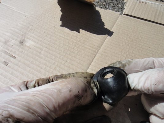

Firstly I got the new dust cover to replace the one I cut off.
Here is the dust cover with the two rubber rings to hold each end on.
Step 1: I got the big rubber ring and slid it over the whole of the ball joint in preperation to secure the top of the dust cover.
TIP: Turn the dust cover inside out first then slide it onto the nut then unroll it up and over the ball joint.

Once youve unrolled it over the ball joint you can grab the ring that you already put on the ball joint and pull it over the top to secure the top.
The bottom is just as easy just pull it up and over the bottom.

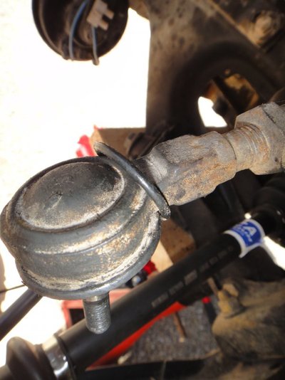

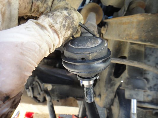

Push the wheel up slide the nuts back into the holes and replace the nuts to the bottom of both ball joints.
I had a problem with one as it was spinning round as I tried to tighted the nut but I got my long nosed pliers and grabbed the stem of the ball joint bar just underneath the rubber dust cover and manged to tighted the nut.

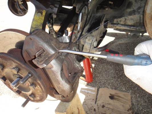

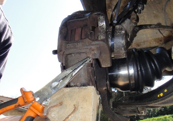

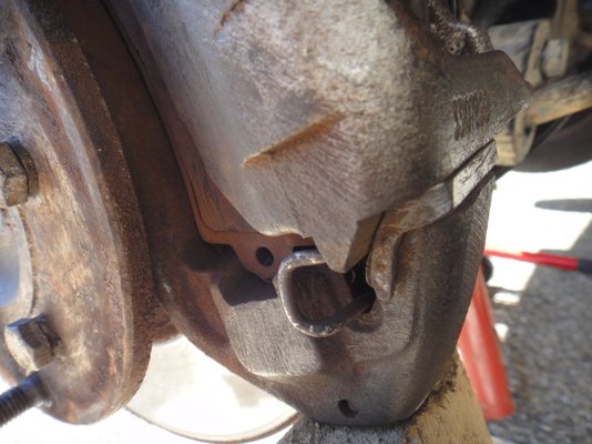

I then slid the brake caliper back on with a bit of wiggling. Slid the shoes back in with a little help of a flat nosed screwdriver, replaced the small pins at the back of the shoes and replaced the two big nuts at the back of the brake caliper.

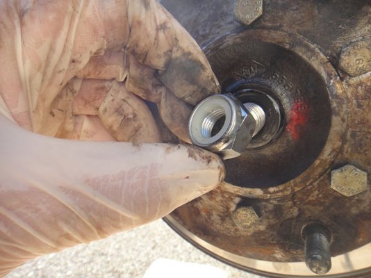

Almost there......
Replaced with the new nut that came with the new drive shaft.

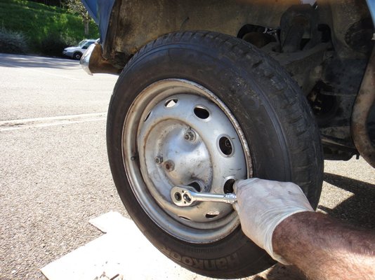

Replaced the wheel and removed all the supports.
DONT forget: Refill with transmission oil.
