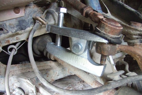

Hi Sprackers, this is how to loosen a ball joint. If it's rusted together, it will need a bit of persuasion with a hammer. Do not hit the bolt that protrudes as you'll ruin the threads. Hit what it goes through, a few times and then try the ball joint splitter again.

Hi Mojo Baby great photo. I have bought a splitter just like that.

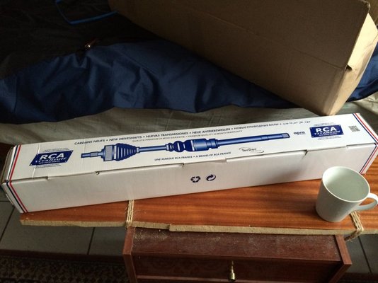

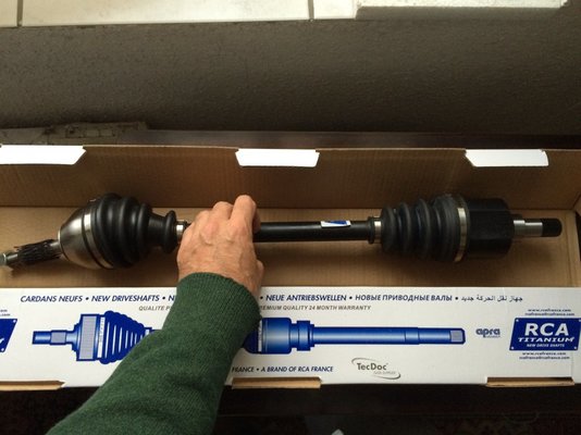

The (first) new drive shaft hsa just turned up.
Looks ok.

That new shaft is looking really GOOD! Can you send me a link to supplier ?
