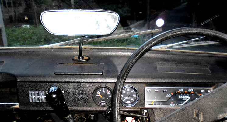

I have so far not had this problem but an easy way to make sure you do not let it happen again is to fit a Temp gauge so you can actually see when the temp is getting hot rather than waiting until the red light comes on which is usually too late. Honest its easy if I can do it , and you do not need to fit it in the dash if you prefer to keep all looking original just put it in a separate "pod"..Robbie

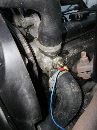

All you need to do is get an adapter bolt/fitting down from external size M18x1.5 to an internal 1/8NPT to fit to the block and put in a temperature sensor for a clock gauge......run a wire from the sensor to the clock and one from the clock to a live on the ignition side and presto no more wondering if shes getting hot and you can judge the temp for the fan cutting in if you have that luxury
