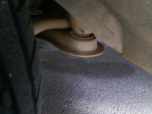

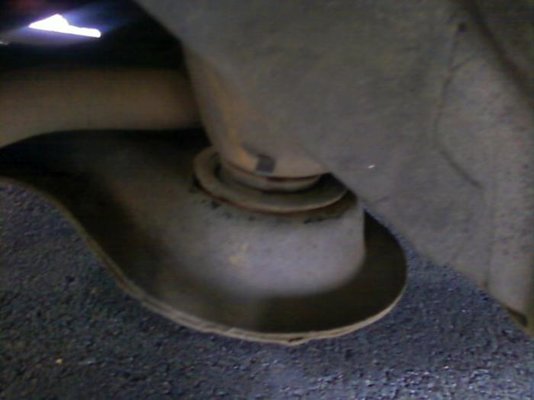

Have just give the old girl a good check over ready for the mot and all seems fine apart from there appears to be a crack appearing on the front cross member above the near side rear bush where it bolts up to the floor. Its almost a perfect circle around the top of the bush but about 1/4 of an inch bigger than the bush insert itself. Other than being like a spacer washer of some description thats coming away due to the worn bush I can only assume its the cross member cracking:(. The car although its done more miles than gods dog is to tidy to scrap in my beleif so although it looks like a b'stard of a job I am wiling to change the crossmember if anyone has got one they wanna donate or sell me cheap?
Nige
Pics OF the Bush
These are the best pics I could grab of the bush. As you can see there is a perfect ring of steel around the top of the bush, I am just not sure if its part of the subframe or does it come as part of the bush kit?
Nige
